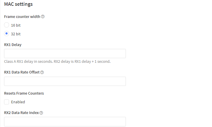

Are you using ABP or OTAA? In case of ABP, what is the frame counter value in the gateway view and what is the frame counter as listed on the device page?
Hi.
  1. ABP
  2. Frame counter value in the gateway view?. I cannot find that gateway view slot.
  3. I have not enabled (checked) the reset frame counters slot on the device settings page.
