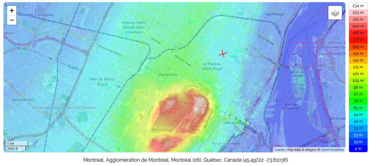

You are right relief is important and will have a big impact on coverage. My antenna will be at the cross on the following map
I should be able to have a good coverage, except south of the city with the mountain…

If the top of your house is at the same level or below the buildings surrounding your house coverage will be a few hundered meters. Even if your antenna is above surrounding building coverage for devices at ground level will be tens to hundreds of meters, depending on the building materials used for anything between the antennas of the node and the gateway.

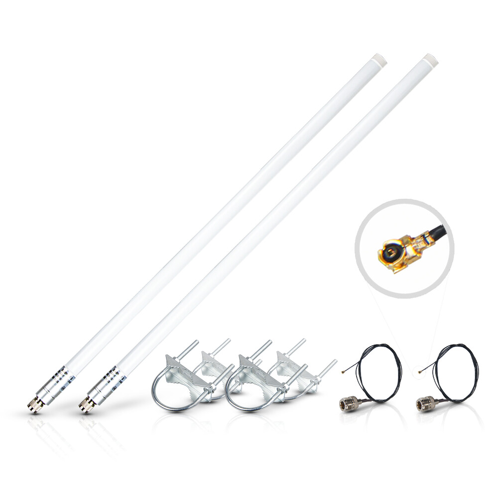

Yes - I got that one. It was a significant improvement over the OEM gateway antenna - both improved device SNR/RSSI as well as maximum range. But then we upgraded to the 8dBi version, which is ~3x larger, and it has been a further improvement - especially if the node antenna is enlarged as well. A (claimed) 12dBi antenna is now on the way.
I’m sure the radio experts view these china antennae with skepticism, and know to be conscious of limits in RF emissions, but we believe this is yet within regulations and are quite happy to report these results.
8dBi working well on 915mhz. Longest range to date ~11km, on a hill
and 12dBi still to be tested
