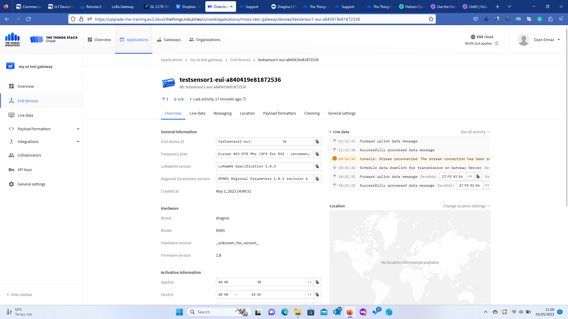

Heres configuration of end device (dragino LHT65)

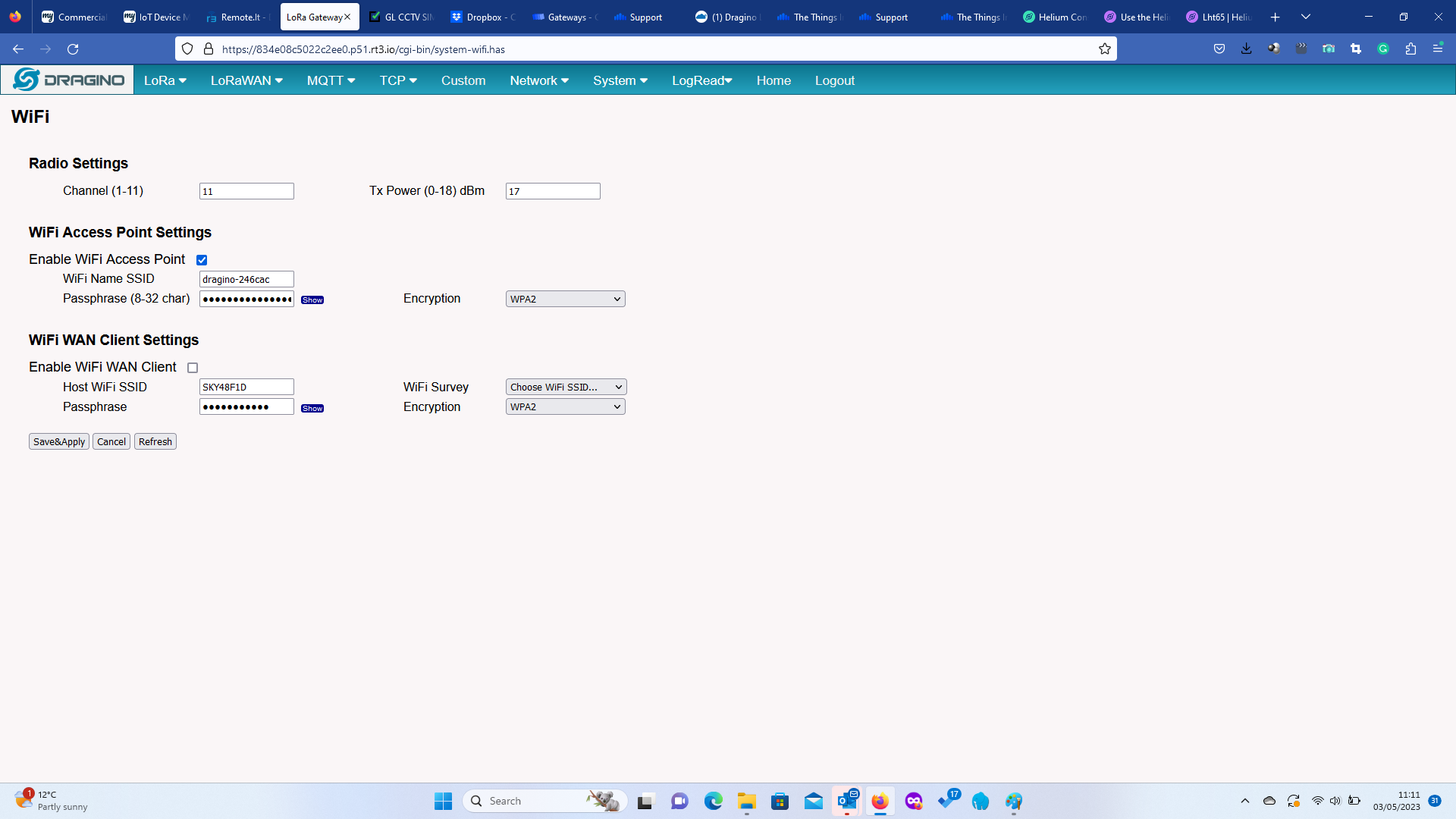

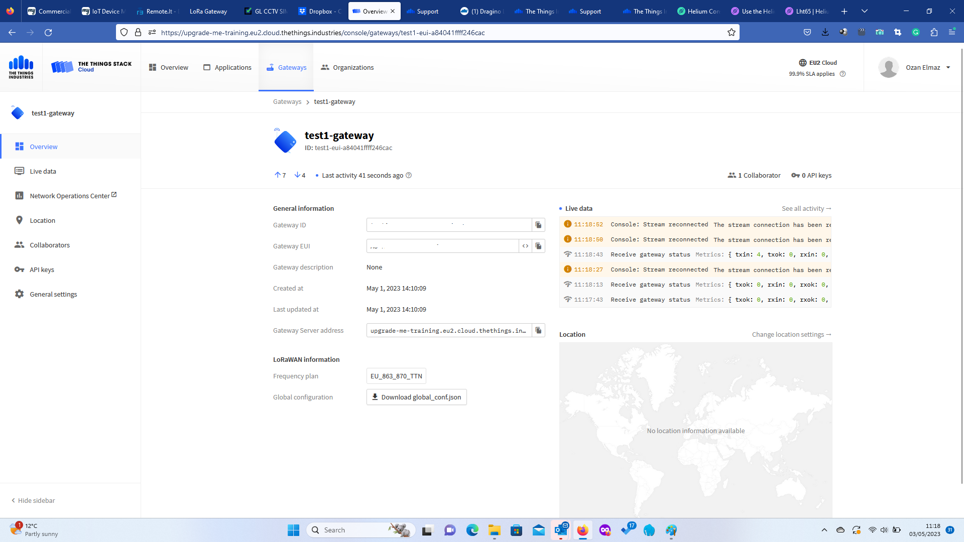

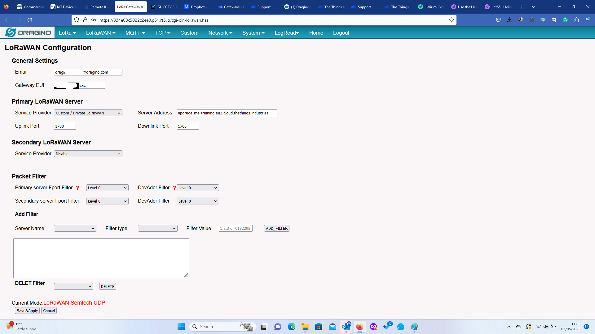

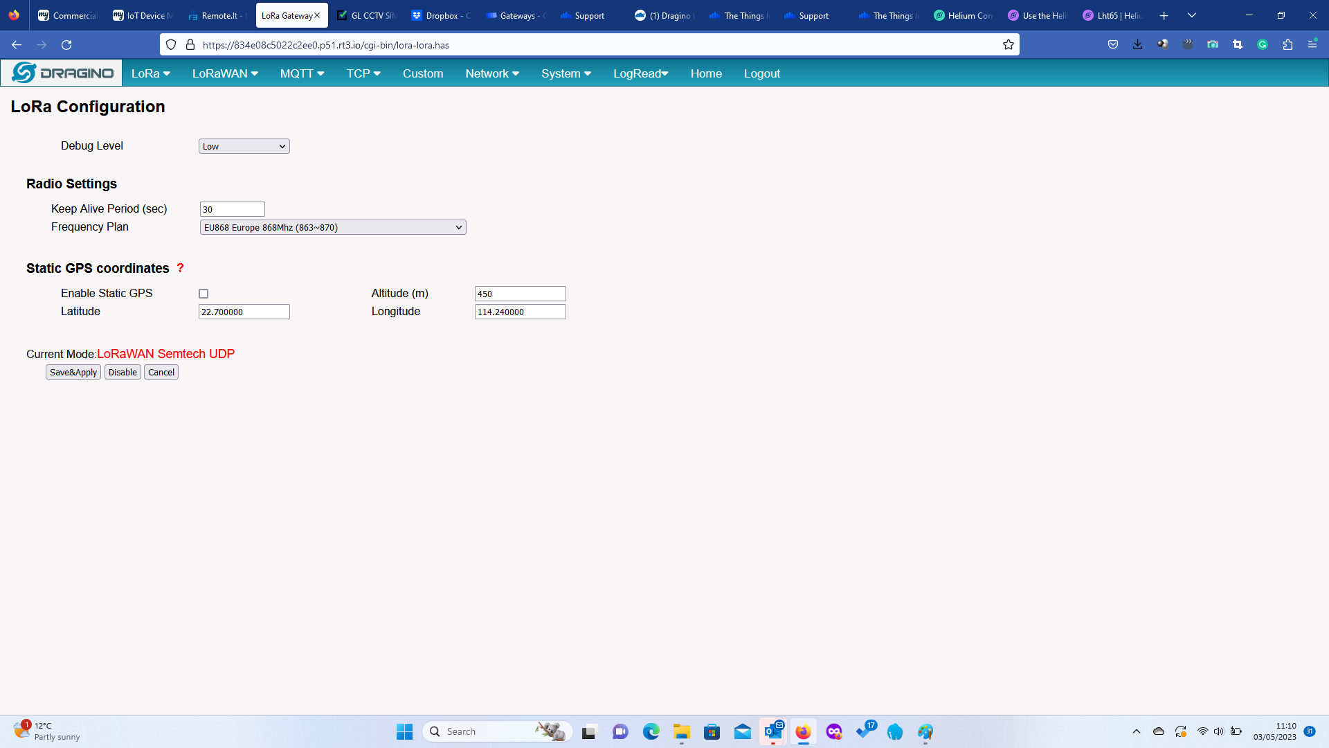

I’ve posted screen shots of my configurations does it seem like I’ve done anything wrong?
Nothing obvious in your settings that are wrong AND most importantly your gateway works when first plugged in.
