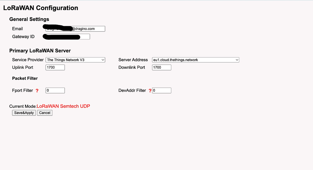

We are configuring a Dragino LG308 to uplink to TTN v3. When we do this via Wifi, everything is working fine, but once we switch to cellular, packets are being dropped.

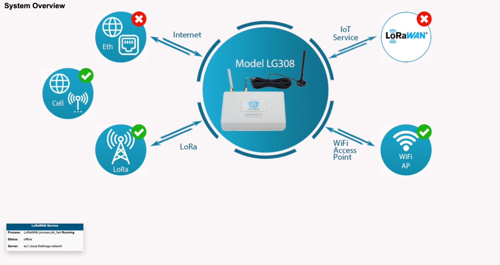

We have cellular connection:

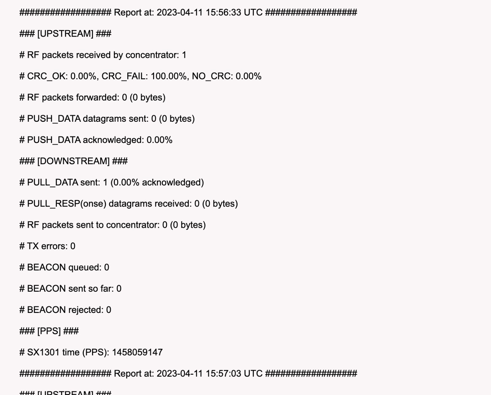

But we see this in the log output:

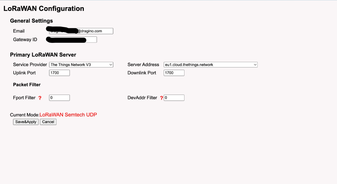

Our lorawan configuration:
What are we missing here?

What we can see from the status:
process: lorawan process pkt_fwd Running
Status: offline
server: eu1.cloud.thethings.network
and from the log output we can see that no packets are forwarded.
Upstream: crc_fail 100%

Means it heard a radio packet and it failed the CRC check. It could be anything. And one radio packet can’t be used to make any deductions.
A co-ordinated test with the device sending every 5 minutes and you capturing the device & gateway logs and the gateway and device web console logs will give you something to go on.
You should also look at the cellular signal strength and experiment with the positioning of the gateway.
Another test would be to use your smart phone to act as an access point, preferably on the same provider and link the gateways WiFi to that.

Wed Apr 12 14:31:27 2023 daemon.info lora_pkt_fwd[2962]: REPORT~ ################## Report at: 2023-04-12 14:31:27 UTC ##################
Wed Apr 12 14:31:27 2023 daemon.info lora_pkt_fwd[2962]: REPORT~ ### [UPSTREAM] ###
Wed Apr 12 14:31:27 2023 daemon.info lora_pkt_fwd[2962]: REPORT~ # RF packets received by concentrator: 1
Wed Apr 12 14:31:27 2023 daemon.info lora_pkt_fwd[2962]: REPORT~ # CRC_OK: 0.00%, CRC_FAIL: 100.00%, NO_CRC: 0.00%
Wed Apr 12 14:31:27 2023 daemon.info lora_pkt_fwd[2962]: REPORT~ # RF packets forwarded: 0 (0 bytes)
Wed Apr 12 14:31:27 2023 daemon.info lora_pkt_fwd[2962]: REPORT~ # PUSH_DATA datagrams sent: 0 (0 bytes)
Wed Apr 12 14:31:27 2023 daemon.info lora_pkt_fwd[2962]: REPORT~ # PUSH_DATA acknowledged: 0.00%
Wed Apr 12 14:31:27 2023 daemon.info lora_pkt_fwd[2962]: REPORT~ ### [DOWNSTREAM] ###
Wed Apr 12 14:31:27 2023 daemon.info lora_pkt_fwd[2962]: REPORT~ # PULL_DATA sent: 1 (0.00% acknowledged)
Wed Apr 12 14:31:27 2023 daemon.info lora_pkt_fwd[2962]: REPORT~ # PULL_RESP(onse) datagrams received: 0 (0 bytes)
Wed Apr 12 14:31:27 2023 daemon.info lora_pkt_fwd[2962]: REPORT~ # RF packets sent to concentrator: 0 (0 bytes)
Wed Apr 12 14:31:27 2023 daemon.info lora_pkt_fwd[2962]: REPORT~ # TX errors: 0
Wed Apr 12 14:31:27 2023 daemon.info lora_pkt_fwd[2962]: REPORT~ # BEACON queued: 0
Wed Apr 12 14:31:27 2023 daemon.info lora_pkt_fwd[2962]: REPORT~ # BEACON sent so far: 0
Wed Apr 12 14:31:27 2023 daemon.info lora_pkt_fwd[2962]: REPORT~ # BEACON rejected: 0
Wed Apr 12 14:31:27 2023 daemon.info lora_pkt_fwd[2962]: REPORT~ ### [PPS] ###
Wed Apr 12 14:31:27 2023 daemon.info lora_pkt_fwd[2962]: REPORT~ # SX1301 time (PPS): 62901740
Wed Apr 12 14:31:27 2023 daemon.info lora_pkt_fwd[2962]: INFO: [jit] queue is empty
Wed Apr 12 14:31:27 2023 daemon.info lora_pkt_fwd[2962]: INFO~ ### [GPS] ###
Wed Apr 12 14:31:27 2023 daemon.info lora_pkt_fwd[2962]: INFO~ # GPS sync is disabled
Wed Apr 12 14:31:27 2023 daemon.info lora_pkt_fwd[2962]: INFO~ ##### END #####
Wed Apr 12 14:31:27 2023 daemon.info lora_pkt_fwd[2962]: RXTX~ {"stat":{"time":"2023-04-12 14:31:27 UTC","rxnb":1,"rxok":0,"rxfw":0,"ackr":0.0,"dwnb":0,"txnb":0}}

Wed Apr 12 14:33:27 2023 daemon.info lora_pkt_fwd[2962]: INFO~ # GPS sync is disabled
Wed Apr 12 14:33:27 2023 daemon.info lora_pkt_fwd[2962]: INFO~ ##### END #####
Wed Apr 12 14:33:27 2023 daemon.info lora_pkt_fwd[2962]: RXTX~ {"stat":{"time":"2023-04-12 14:33:27 UTC","rxnb":1,"rxok":0,"rxfw":0,"ackr":0.0,"dwnb":0,"txnb":0}}
Wed Apr 12 14:33:34 2023 user.notice iot_keep_alive: Internet Access OK: via 3g-cellular

Wed Apr 12 14:33:49 2023 user.notice iot_keep_alive: Internet Access OK: via 3g-cellular

Given that you seem to be getting packets with CRC errors only I would move the cellular antenna to check if that reduces the CRC errors,
