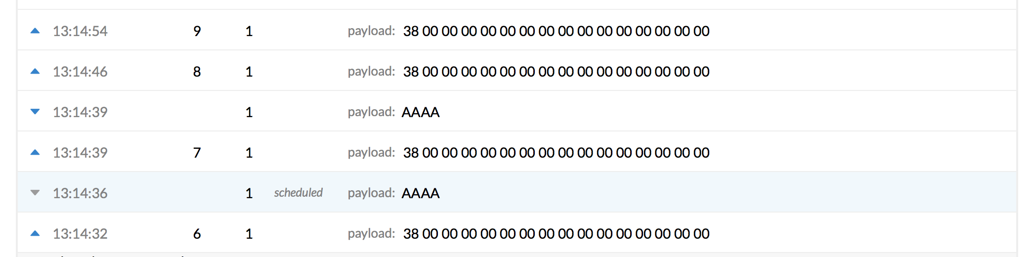

I have successfully established uplink communication from node to TTN, and I can view all the traffic. Now, my next step is to figure out how to do downlink…

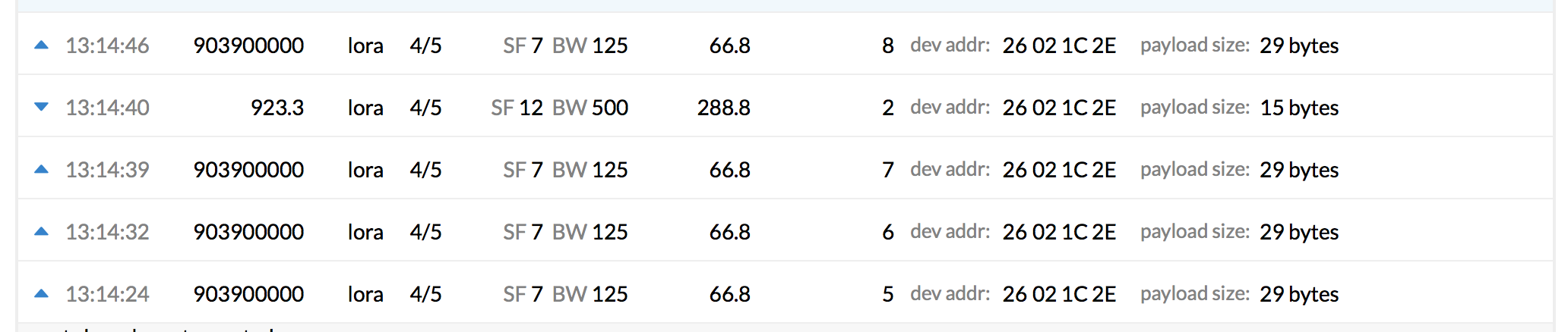

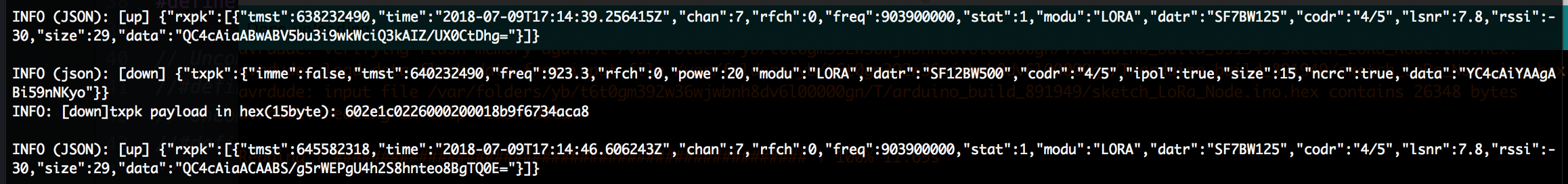

I am simulating downlink messages from the TTN console, and I can see that the payload is scheduled, then delivered. Also, the console output from the Dragino gateway itself shows that the downlink message was indeed received, and forwarded (if I am not mistaken) but I get nothing in my node’s log.
I tried to confirm if the packet forwarding code used supports downlink and I found this in Github - Gateway Packet Forwarding Code - and it seems to support downlink.

Gateway Console
TTN Device Data
TTN Gateway Traffic
