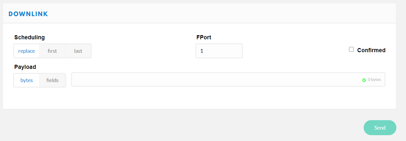

Hi @fandrit, the answer is yes. The same downlink function exists on the web console in version v3.8.3 which is the latest version. I have used it and can report that it works in the same way. If you also use the web console to look at the application or device data then you get a lot more information on v3 than the current TTN v2.

Version 3.8.3 is now installed and it seems that the downlink function is there now!
