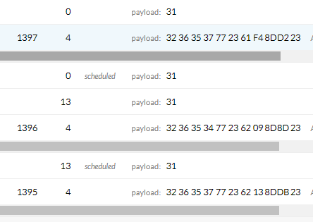

I am trying to send a DL from TagoIO and my downlink reaches the TagoIO successfully. But, during the time of execution of the DL another DL appears with port 0. Don’t know from where it occurs.
Below image for your reference
Can any one help me on this.
This DL from port 0 replaced my downlink coming from the TagoIO and my command is not getting executed.

As we can’t see the little icons on the left hand side, I’m assuming you’ve scheduled a request on port 13 with a payload of 31?
Yes you are right, I do schedule the downlinks on ports with its values.
Here its port 13 with payload 31.
Interestingly, in v2, you can schedule a downlink on port 0.
And it appears that’s what’s going on here - counting from the bottom using an index of 1 (I’d use times, but we can’t see them):
Line 2 shows a port 13 downlink schedule with payload 31
Line 4 shows it being sent (I think, hard to tell, can’t see the left hand column)
Line 5 shows a port 0 downlink scheduled with payload 31
Line 7 shows it being sent.

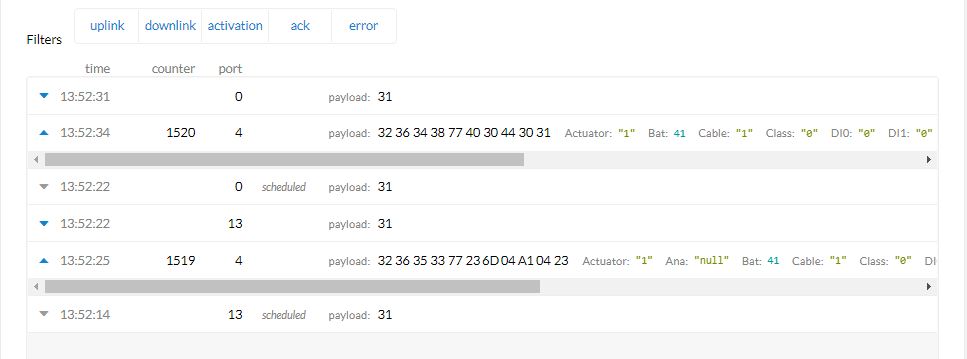

Rather than sending the downlink via TagoIO, can you try it directly on the console to see what occurs.
And if you are posting a screen shot, include the icon & time column.
Ok i will check by sending a downlink directly from the console.
Here is the full screen shot for your reference. This i have regenerated it now.
Let me check from the console and will let you know the result
Thank you
I have sent a DL using the console, when sending using console i don’t get an DL scheduled on port 0 and it works fine.
What might be the issue? why does port 0 occurs when sending a DL from TagoIO?

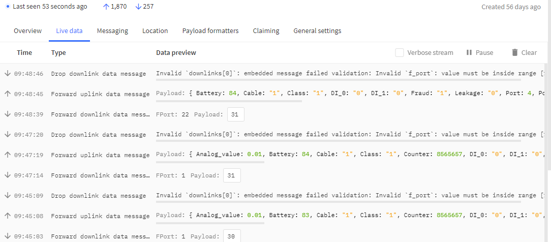

Hi descartes,
I have tested with the TTI/TTS the same occurs.
I am getting a downlinkon port 0, but in TTI/TTS that DL on port 0 occurs after each uplink.
Image attached for your reference.
What might be the solution for this?
