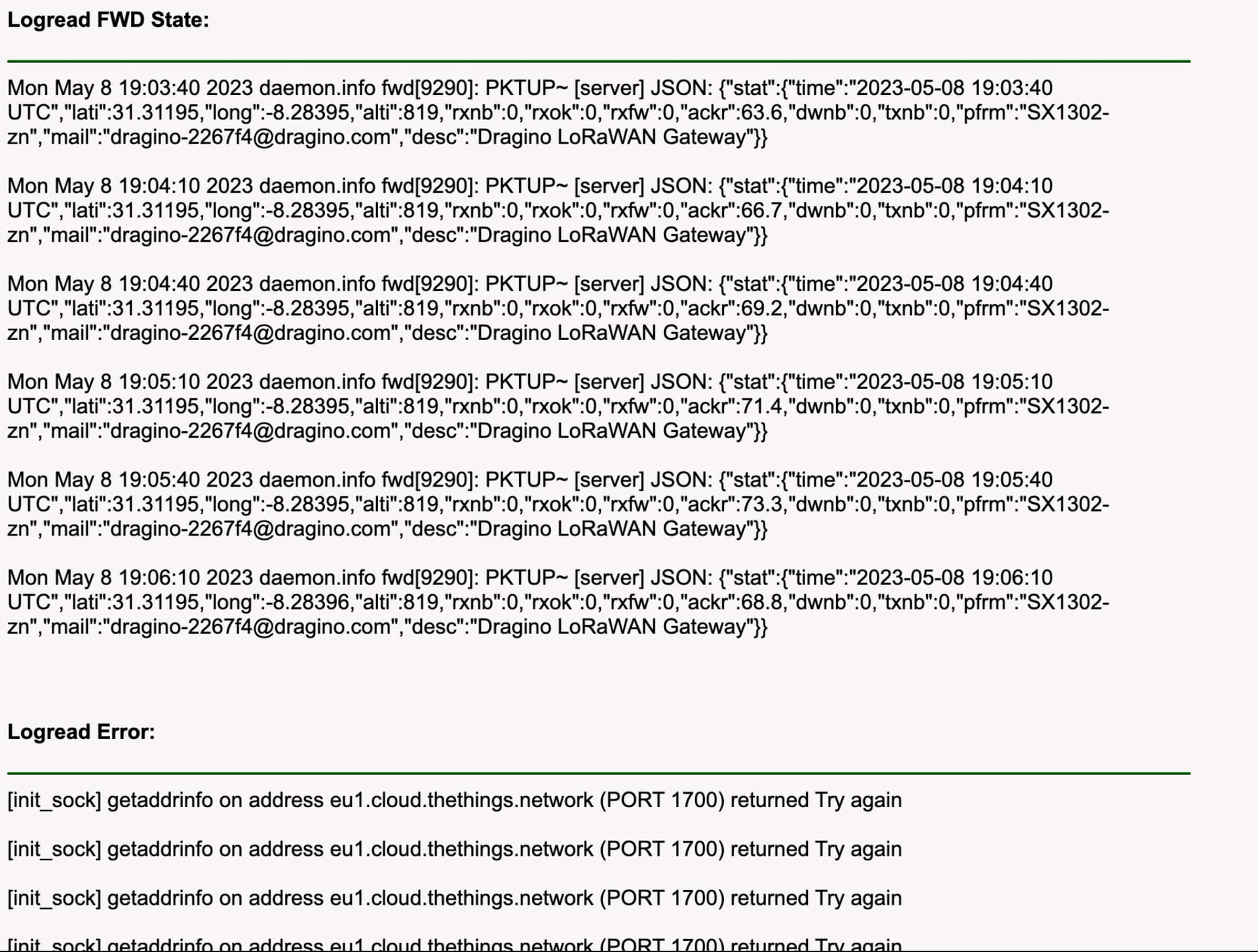

I have had a DRAGINO DLOS8N 4G gateway connected (with a 4G sim card only) in a farm for more than 4 months now with no issue or disconnection.
Today, it started behaving weirdly, connecting and disconnecting frequently and then changing IPs, which leads to TTN server identifying it as offline.
Here are some screenshots :
Any idea what is happening, or how to solve this ? Nothing has changed from 4 months ago up until now, this behaviour started today without apparent cause.

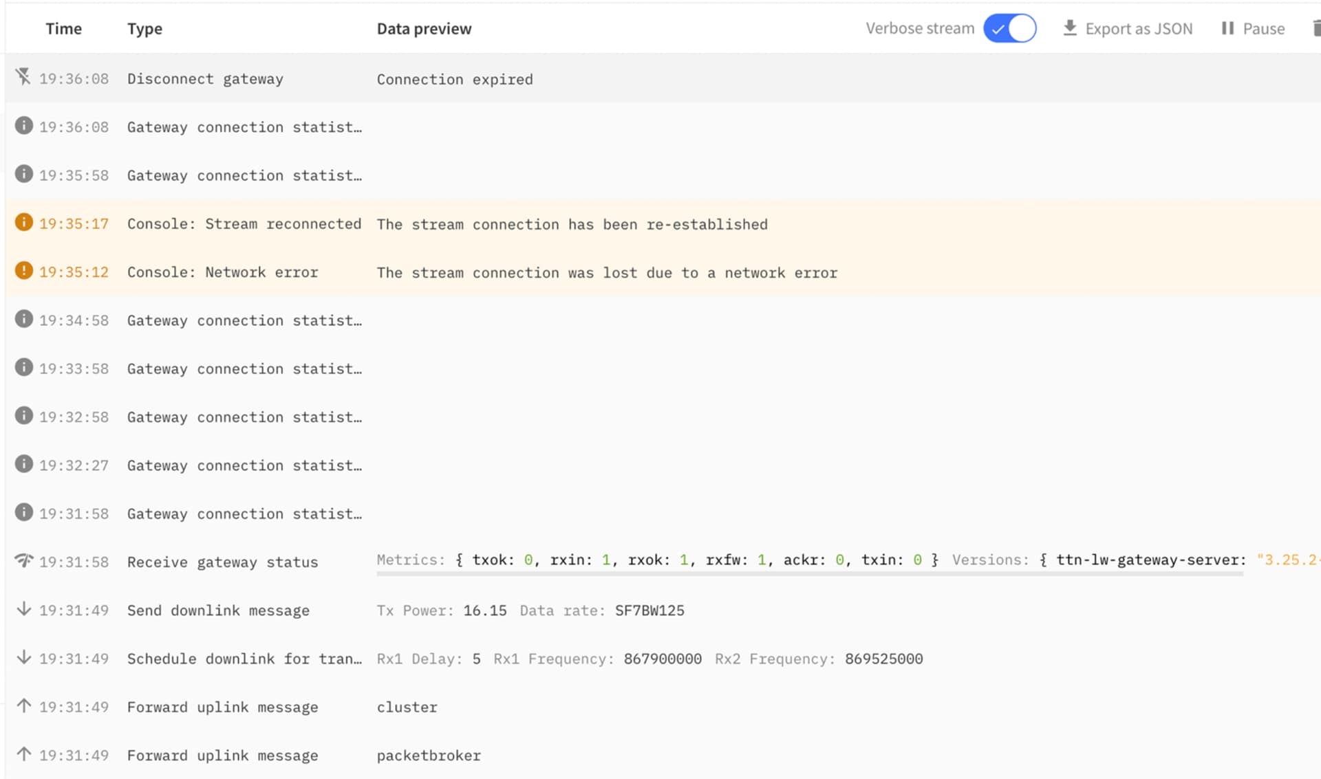

are you referring at the events at 19:35:12, 19:35:17, 20:12:11 and 20:12:22
Nope, I know those are meta events.
I am referring to the Gateway disconnect / connexion expired events.
HB

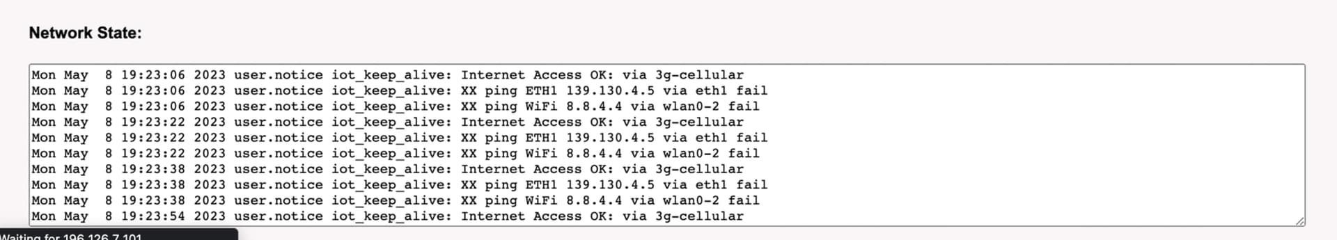

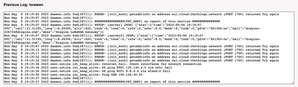

Where in the world are you? Can you see any stats for the quality of the cellular connection? Though you call out use of 4G it may be you are actually running on a 3G link and in some parts of the world 3G is being shut down(*) (often gradually) as BSN’s switch to 4G/5G. If a close by BSN is down for maintenance/upgrade or just failed or indeed taken out of service for 3G and your system has failed over to linking to a more remote BSN it may be causing intermittent backhaul link if signal strength poor. WRT disconnect/connect ‘issue’ see comments in the other post you questioned earlier and also Forum search :wink:
