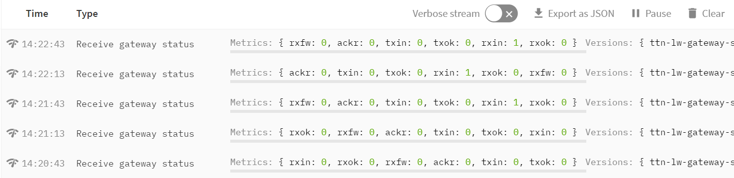

I have a DLOS8 gateway connected successfully to TTNv3 but i don’t need to receive he its gateway status:
Is there a miss configuration?
Thanks for your help and have a good day.
You may not but the back end LNS certainly does - with no status update it is assumed offline and will not be used to route packets!
You need this - shoudl be typically every 30 sec - 10 sec probably too often 1 min probably ok, more than 5min and will likley assume offline! Believe default on most builds is every 30 sec.
