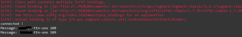

I made use of some of the components of the now-deprecated Java SDK, modified it a bit, and tried out your suggestion to resolve the authorisation error.
It worked! :smile: Thank you for your help!
