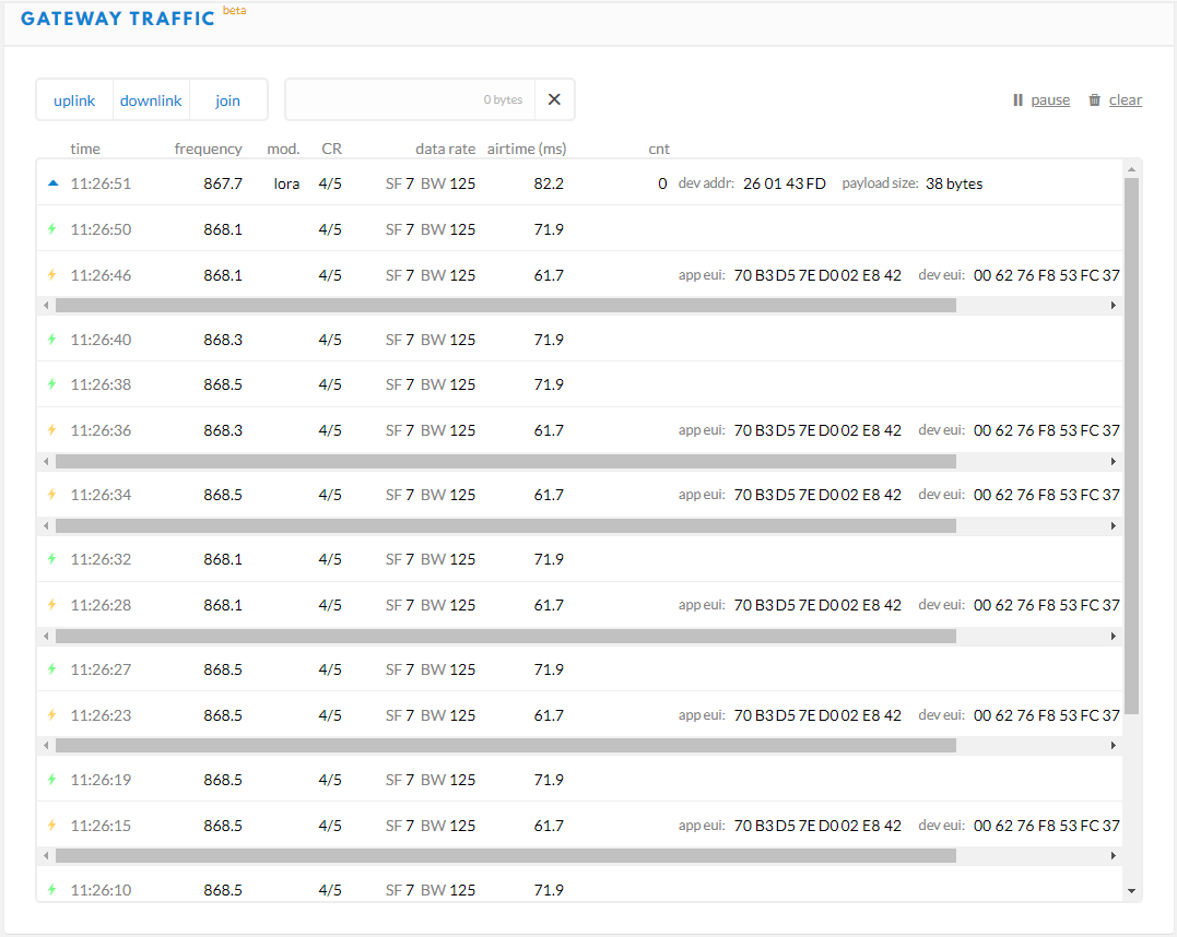

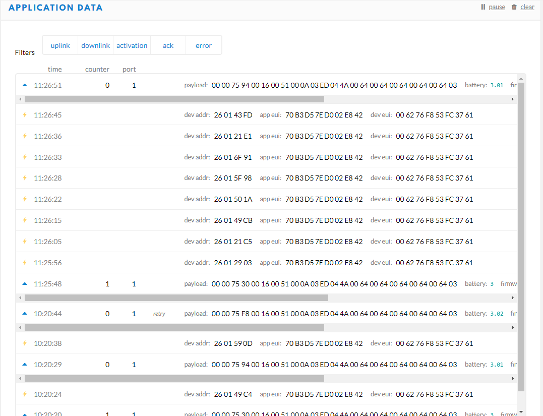

Can anybody explain what happens in the device communication depicted in the picture below?
device_2020-11-11c
What causes this activation resending and resetting of the counter?
The device (Arduino Pro-mini and RFM95) is using the LMIC library and LowPower sleep.
The gateway (RAK831) data is depicted below:
gateway_2020-11-11
All tips are welcome to get me on the right track :thinking:
