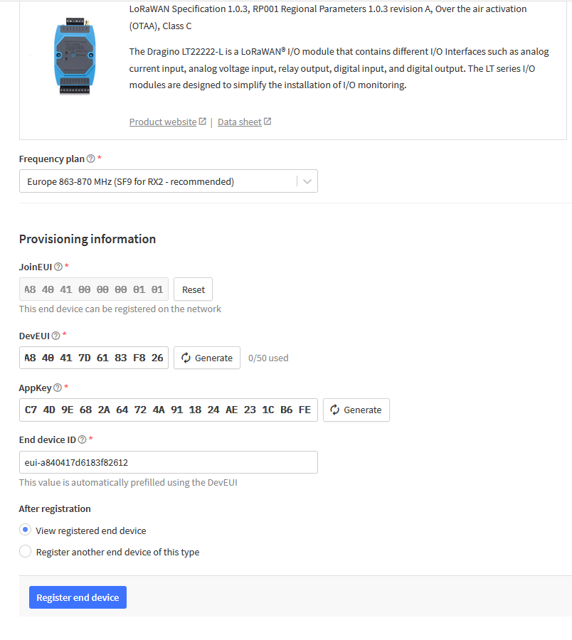

I register the endnode device_id": "eui-a840417d6183f826-21 to application gauscagdas, then I have delete it 5min later with following json event report.

The original device doesn’t seem to have been created properly.

If you see, there is no device/join EUI here.
How did you create the device? Did you use the device repository to fill the details or did you fill all the details manually?

This is the first time I am using this type of endnode (Dragino-LT22222). I am registering it for the first time.
I registered it as in the attached picture, but it means there is another problem.
I think it’s possible that the original owner of this device did not remove it before selling it to you.
Where do you purchase the device from?

The device I got was the manufacturer’s test device. They deleted the old registration, and the problem is solved. Thank you.
