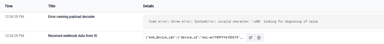

now, at the the event detail of data cake I am facing a problem which is the readings are being pushed tot he webhook but it keeps saying this
Now, to make matter even more confusing I dont know why now my data cake debug is not working resulting pending status at my TTN too. I am keep sending packets, receiving and decoding well in TTN but at my debug there is no response. Since, my TTN is already decoding the payload I assumed I wouldn’t need to have a nother payload decoder at the datacake configuration. One thing for sure I am clear is that my TTN is working as expected but the integration is not set up well. What am I missing? What could be the issue here. Please enlighten me.
