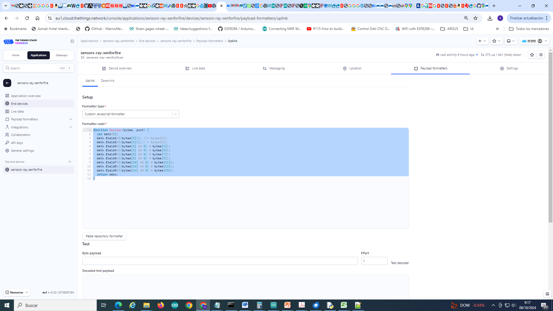

I decoder my data like that:

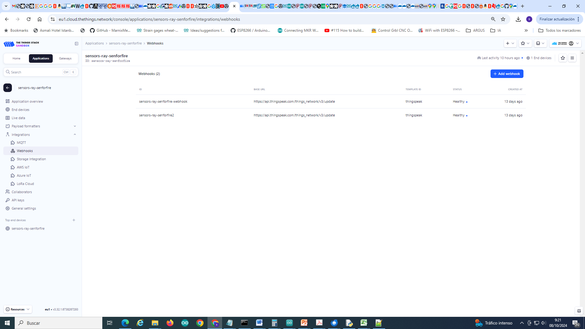

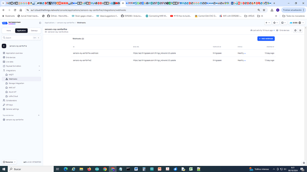

And here you can see my 2 webhooks.
How can I say which data es going to which application?

There is only one Payload Formatter, it doesn’t matter how many web hooks you have, the data transmitted will be the same.
