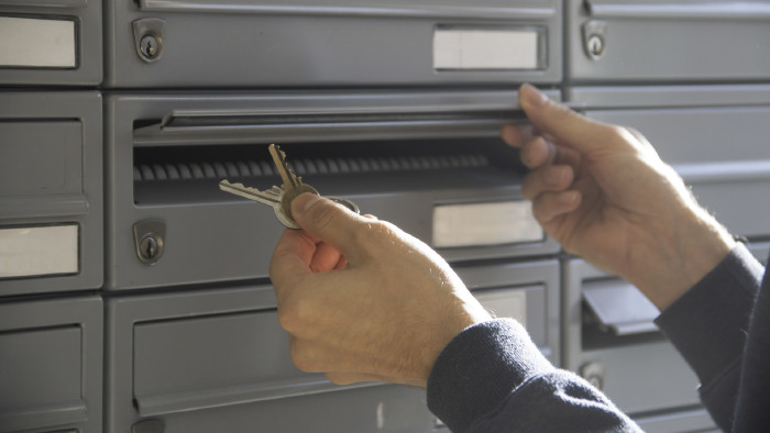

Changing the mailbox is not possible unfortunately. It’s a fixed unit for the whole house.
Looks like this btw.
mailbox
Would it make a difference if I stuck some kind of knob on the inside of the door to force it open a bit?
Theoretically the slit is always open when the mailman throws something in but I don’t know how much latency is to be expected until the message is transmitted.

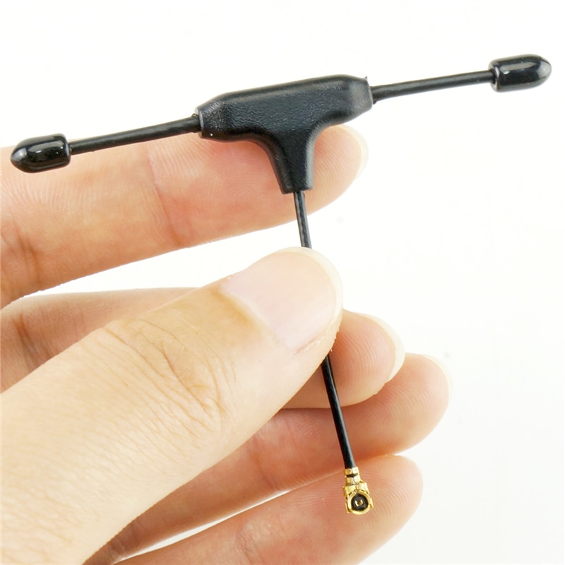

I have tested that using this kind of antenna can improve the reception dramatically.
imagen
You can get a node to wake up, or activate, within a second or two. Wheter this is enough to send a long range packets (circa 1.2secs long) and whether there is enough splatter of the RF through the slot to reach the gateway is somethong you will only resolve with an experiment, much will depend on where the Gateeway is located.
That looks like a dipole, with shorted elements. A standard dipole would have elements around 8cm long. So maybe it has a gain slightly less than a standard 2.1dBi dipole of 1.5dBi or so.
A simple wire would have around the same gain, so if you see a ‘dramatic’ improvement then the previous antennas would have been not so good.
Yes @LoRaTracker the improvement is relative to the FPC antenna that we usually use with that mailbox sensor

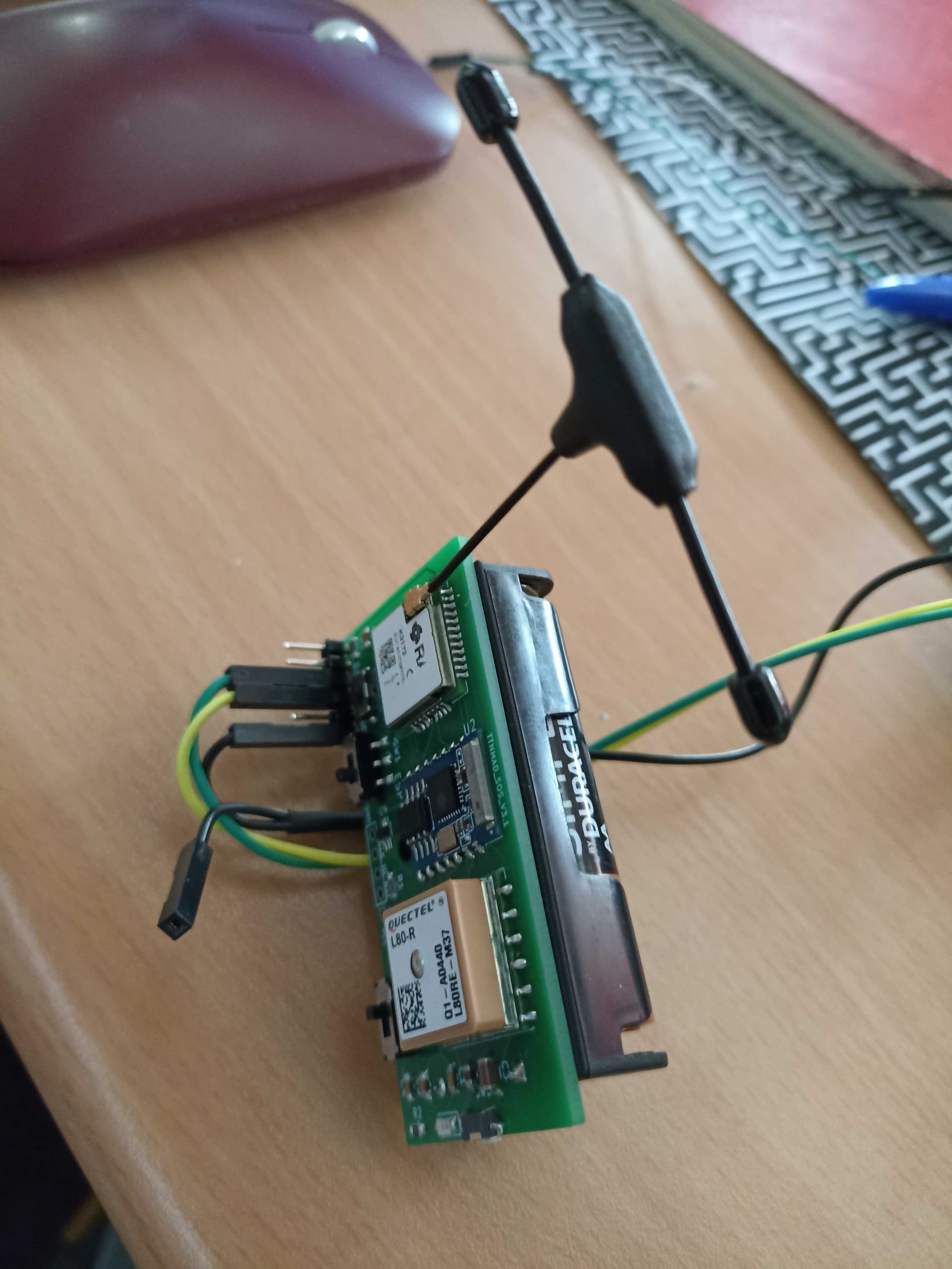

I was curious though, why do you have a GPS on a sensor thats in a mailbox ?
Hi LoRa Tracker, that photo is from a different node; it’s a SOS sensor with geolocation using GPS and WiFi access point MAC through wigle.net
