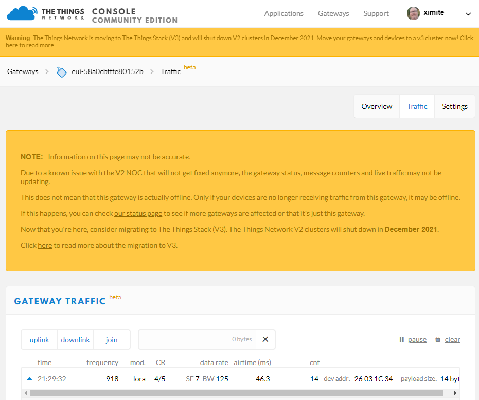

I have TTIG registered as a gateway in V2. Everything works.

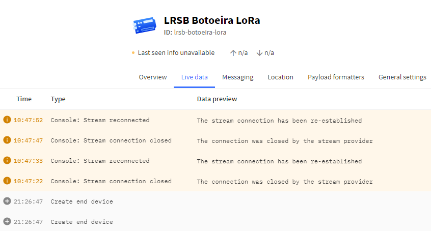

I have already registered the Device and the application, but nothing appears in V3.
Nothing, it just works.
What is the device? Does its uplinks appear in the gateway console?

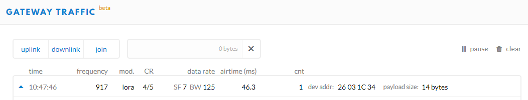

Yes, in V2 i got traffic.

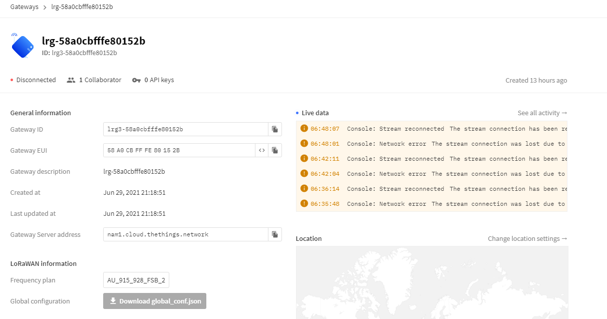

Here is the gateway on V3.
It WILL NOT appear on v3 as you haven’t run the CLI commands - delete this entry, it is probably blocking the v2 packets arriving due to the two EUI’s clashing.

It appears you used a DevAddr from v2 - either because you registered it there first and moved it to v3 or you used a v2 DevAddr.
So you can either delete the v3 entry and re-register it so it gets a v3 DevAddr.
Or you can try the CLI or console migration of the TTIG.
