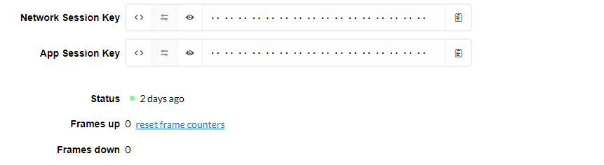

it says its last seen 2 days ago when i got them, but you can see its not sending no packets.
i cant connect any of them, i suspect they cant talk to the TNN network, i have entered all the right APPkey, APPeui and DEVeui.

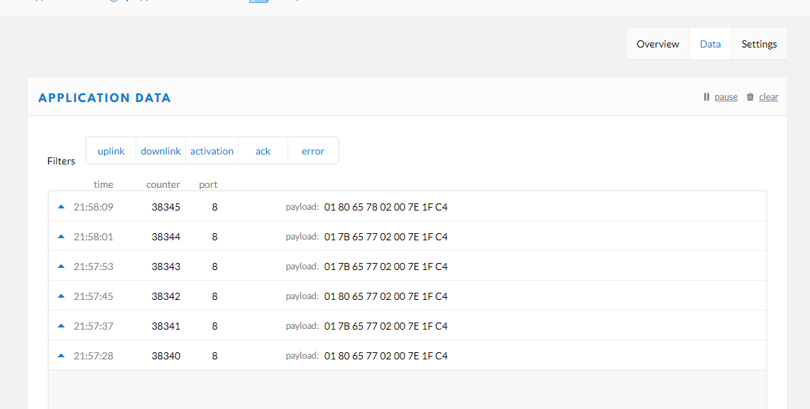

i got another sensor by risingHF (temp & humidity sensor), this has traffic in the data section:
netvox, i have temp & humidity and door sensor, both which i joined to the TNN from the looks of things.
this is my traffic from my gateway traffic page, its all coming from the rising HF

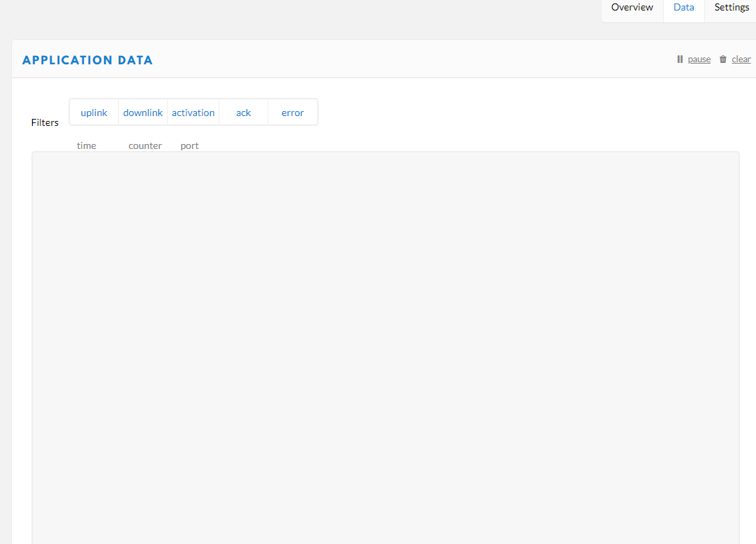

for my netvox, i dont have any traffic, see below:

you showed that console data, So your gateway seems to work :wink:
but… fom what I see is that your risingHF sensor is violating TTN’s fair use policy by transmitting 22 bytes every 8 seconds @ SF9
see
so gateway is working ( i will figure out how to reduce the uplink frequency)
but how do i get the netvox working and talk to the gateway? any ways i can do a test or get error logs?
@jistar the R711 that I was experimenting with uses AS923 and it appears your gateway is setup to use AU915 by the look of the frequencies above
That may be a first place to look
