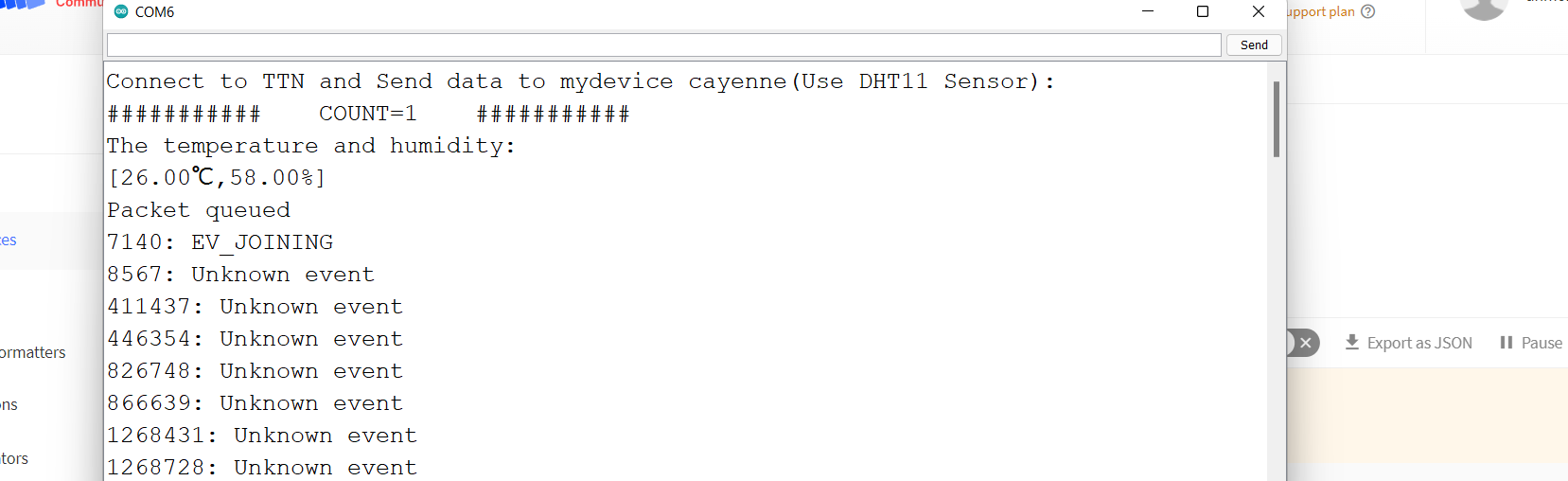

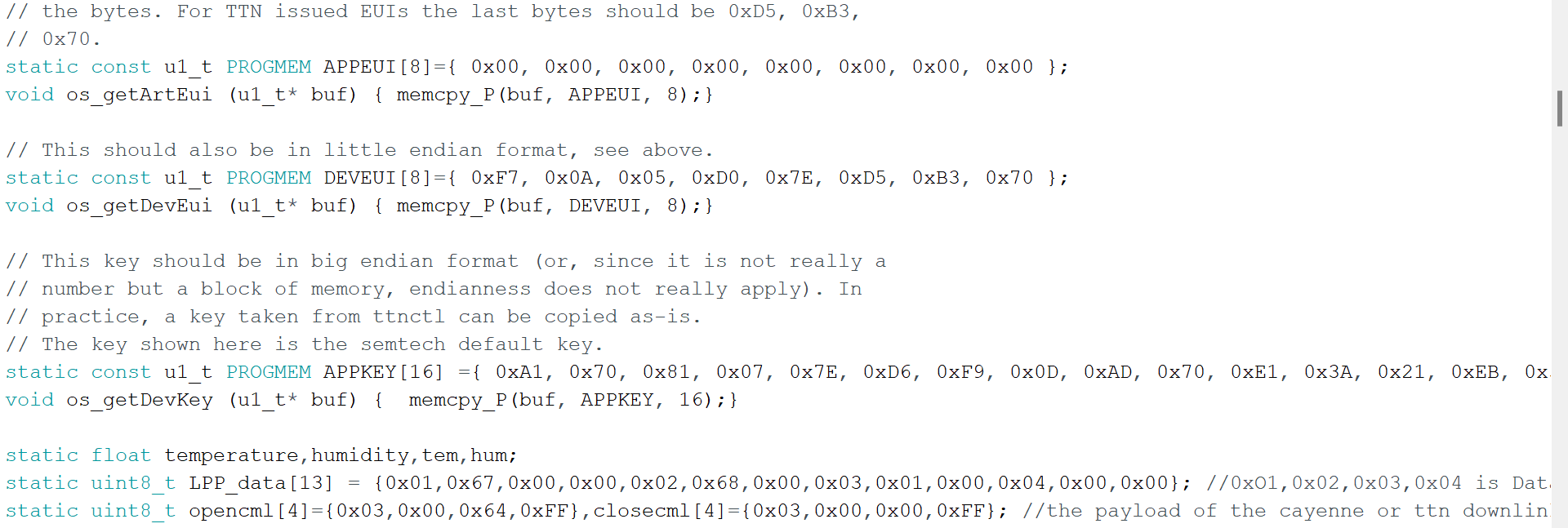

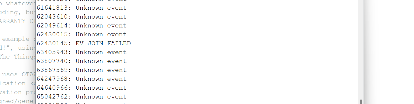

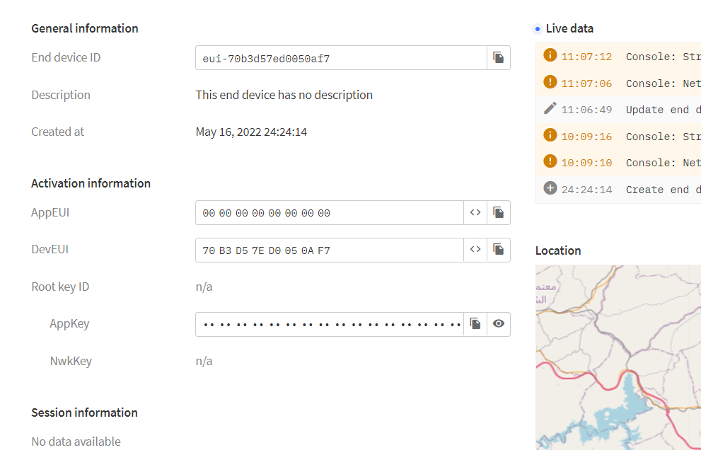

updates on the situation

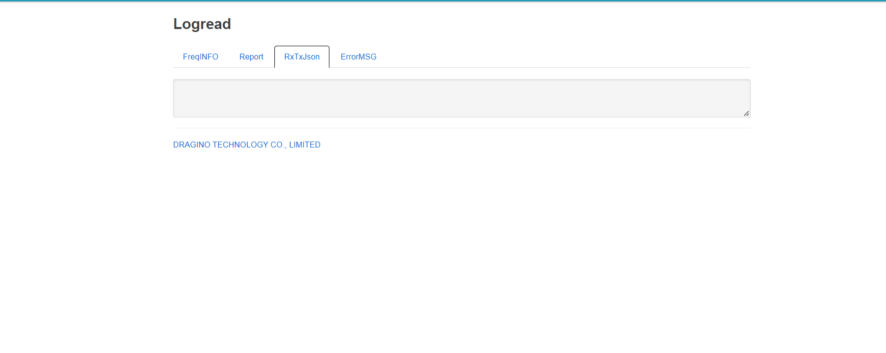

a add an appeui and checked logred and found this
One of the screens suggests that you may be trying to use a Dragino LG02 device as a Gateway, is this is correct ?
yes , i am using it as gateway
Then its not supported on TTN.
