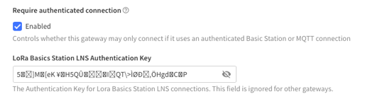

I am trying to update a Gateway using the REST Api to Configure CUPS to send the LNS API Key. The steps to do this manually are documented here:
https://www.thethingsindustries.com/docs/gateways/concepts/lora-basics-station/cups/
For quick reference, this is the area on the Console I am trying to set via the Api.

So it looks like everyone works until I check the console.
I’m not sure what I’m doing wrong. Has anyone else done this?
The schema indicates it’s a byte string, I’m not sure if I’m not formatting it right? I tried stuff like base64 decoding and converting to a byte-string, but that didn’t help. I’m hoping someone can save me from this game of guess and check! :slightly_smiling_face:
