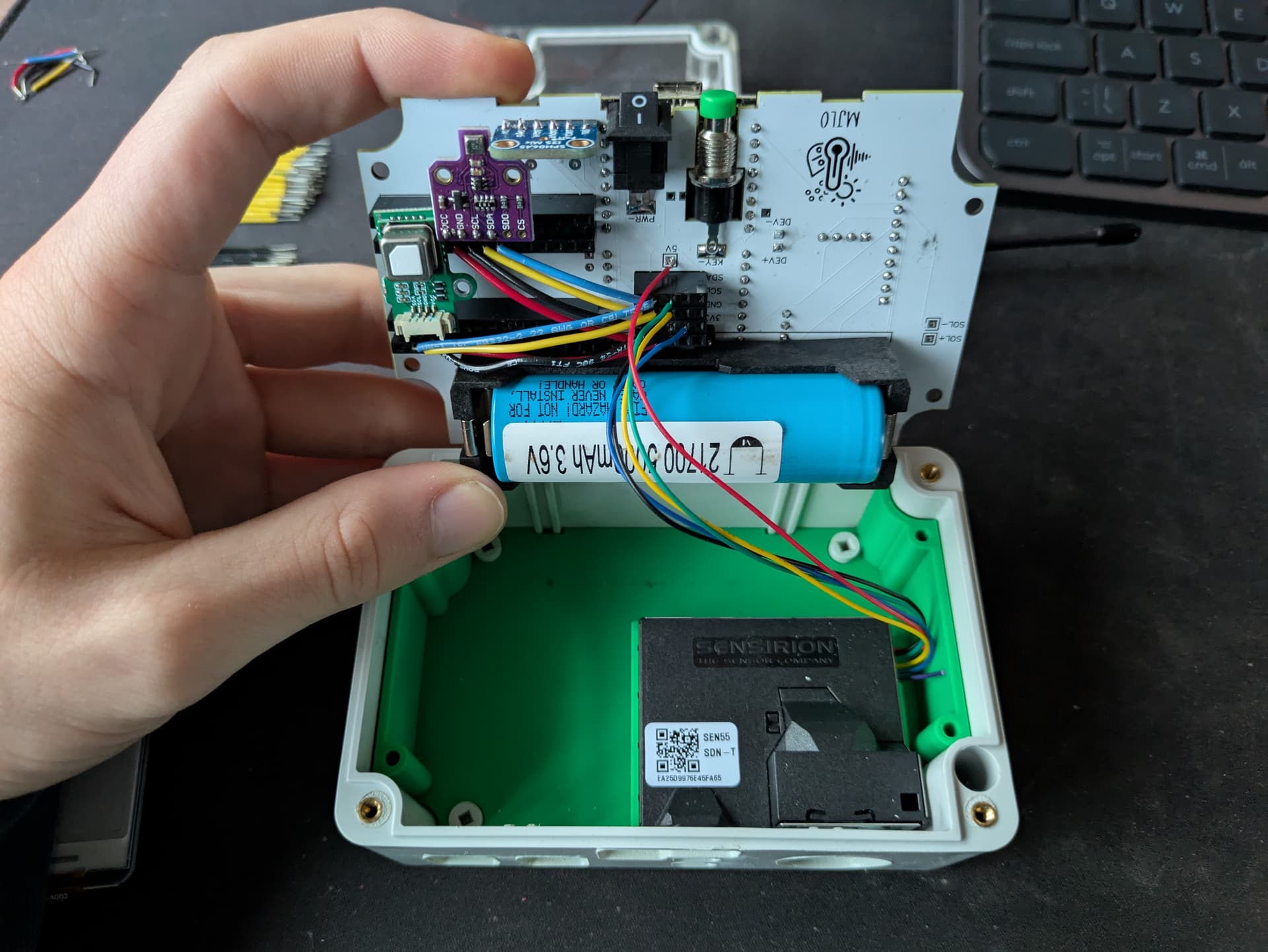

The top of the box (with some wires removed for surgery, and display removed from its pins to see underlying stuff):
The inside of the box:

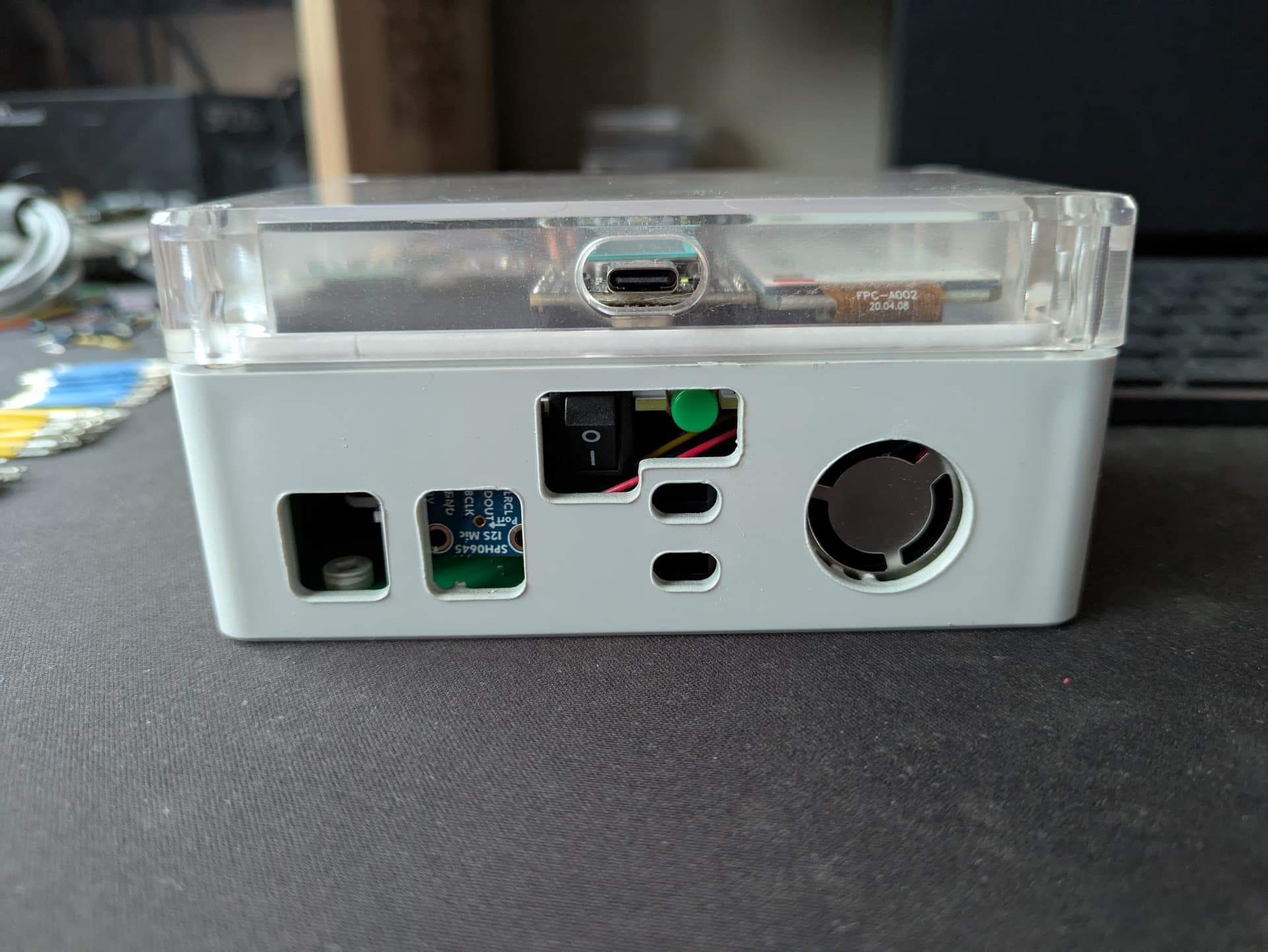

The ‘bottom’ of the box with breathing holes (the rest of the box is watertight, so can be mounted outdoors without major problems):

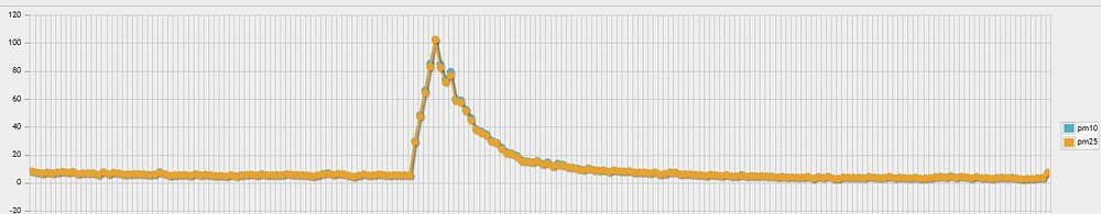

This is Particulate Matter measurement in my room after I soldered for close to half an hour:

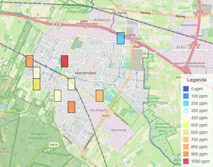

These were the CO2 levels at a bunch of locations around town (last year, previous generation boxes, not very reliable data, new boxes ready next month for better measurements):
