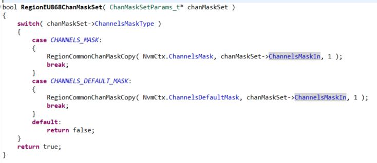

Greetings deer members,
I am using a Murata typeABZ chip as end node with the ST LoRa librairies.
I actually have a single channel Dragino Gateway for test purposes only and I want to use only 3 channels to loose “only” 2/3 of my packets during my tests.
I assume there is something to do in the RegionEU868.c code like here
but I tried different things that did not reduce the number of channels my module emits on.
Do you have an idea of which code I need to modify from the original files ?
Thank you.
See this issue on Github for how to properly do the channel mask, endorsed by the developers. This issue is on the original LoRaMAC-node project by Semtech, which is forked by ST.
https://github.com/Lora-net/LoRaMac-node/issues/742#issuecomment-492231231
