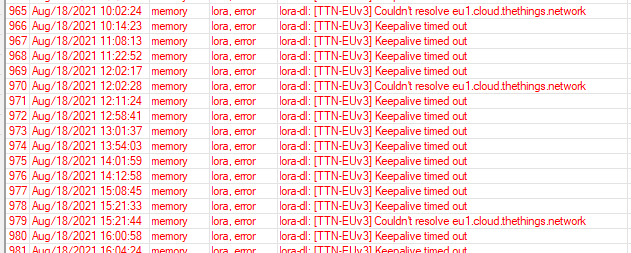

Did you have something in the logs of the affected gateways?
Since the migration of my wAp Lr8 Kit (Package Version 6.48.3) to TTS CE keepalive timeout and DNS issues got very common.
I have noticed minor outages and it always recovered to normal operation without manual intervention.
But somehow the connection is less “smooth” as before the migration.
