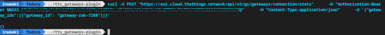

Greetings @jssani thanks for your quick reply.
I’ve tried to make the request in the way that you proposed, that is:
curl -X POST "https://eu1.cloud.thethings.network/api/v3/gs/gateways/connection/stats" \
     -H "Authorization:Bearer NNSXS.xxyyyzzz" \
     -H "Content-Type:application/json" \
     -d '{"gateway_ids":[{"gateway_id": "gateway-rak-7268"}]}'
And the error actually disappear, however, I get an empty JSON as response and the response code is “None” as can be seen in the image below:

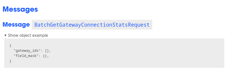

Also, I’d like to ask you about the proper usage of the “field_mask” field in order to issue the request, since it is not quite clear.
As far as I understand, it is not mandatory to be included in the body’s request, only the “gateway_ids” field is mandatory.
Thanks in advance.
They are a list of fields that you want returning in the response - some you get regardless anyway, but if you need a particular field, you can specify it there.

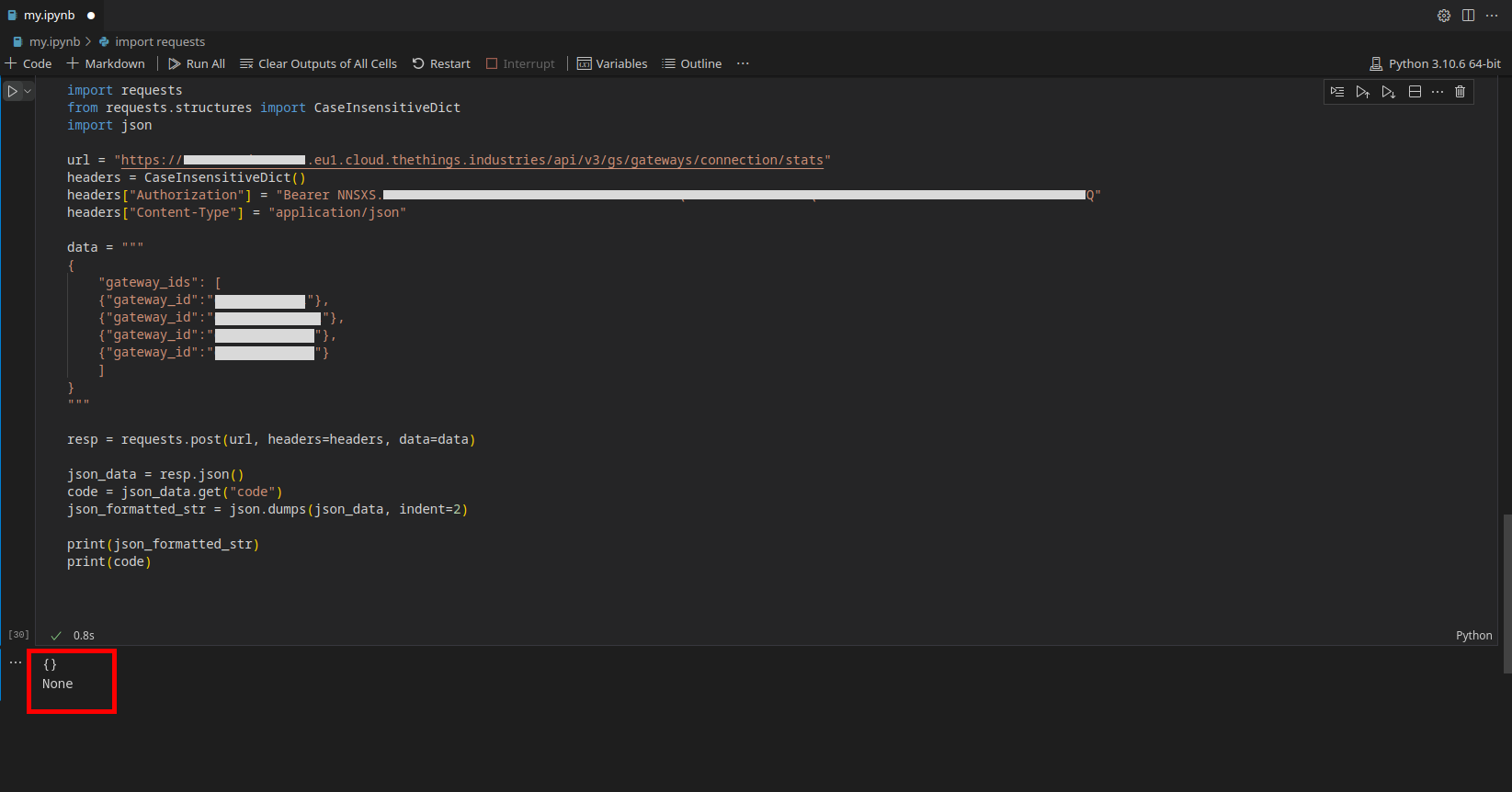

Greetings @jssani,
Thanks for the quick reply by the way.
I’ve just tried what you suggested but I still get exactly the same behavior.
I’ve tried getting the gateways’ stats from two different accounts because I was suspecting that maybe I was requesting the info from a gateway which has been inactive and, for that reason, it might not have stats to consult, however, the following screenshot is the request for a bunch of gateways that I’m certain to be active and operating flawlessly.
Thanks in advance
