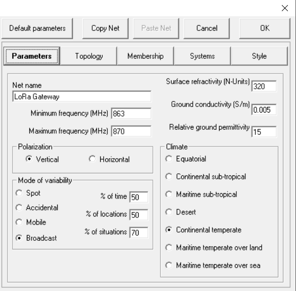

I’ve made my first steps with Radio Mobil and created some connectivity maps, where the coverage pretty much reflects the height profile of the area, which is quite reasonable. Improving the antenna height improves the coverage -> makes sense as well. The next step for me would be to assume more realistic parameters and understand more about the software. What settings do you recommend for:
  1. Surface refractivity
  2. Ground conductivity
  3. Relative ground permitivitty
  4. Mode of variability

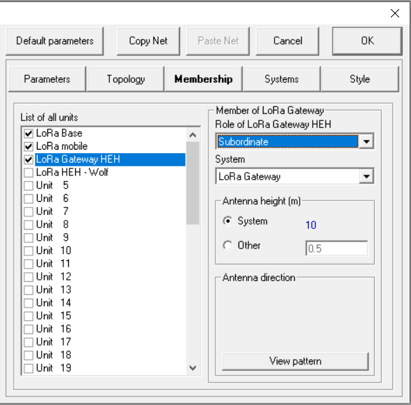

  5. Membership: command or subordinate?

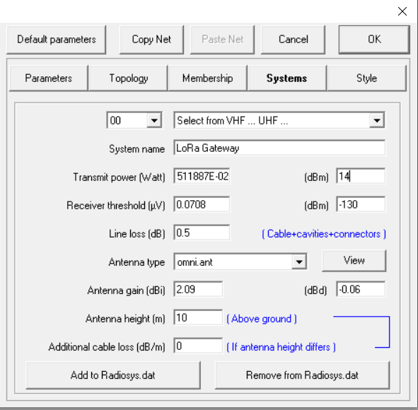

  6. Systems: what is a realistic sensitivity to assume? Is it really the -144dBm or more like -125dBm?
  7. Style: I don’t get when red, yello and green lines are drawn with respect to the 14dBm setting of the transmitter.
    Please see some screenshots of the terminals below:
rm_style rm_systems rm_membership rm_parameters
