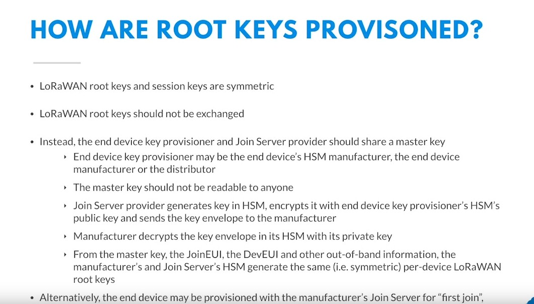

maybe this interesting webinair helps
54%20PM
