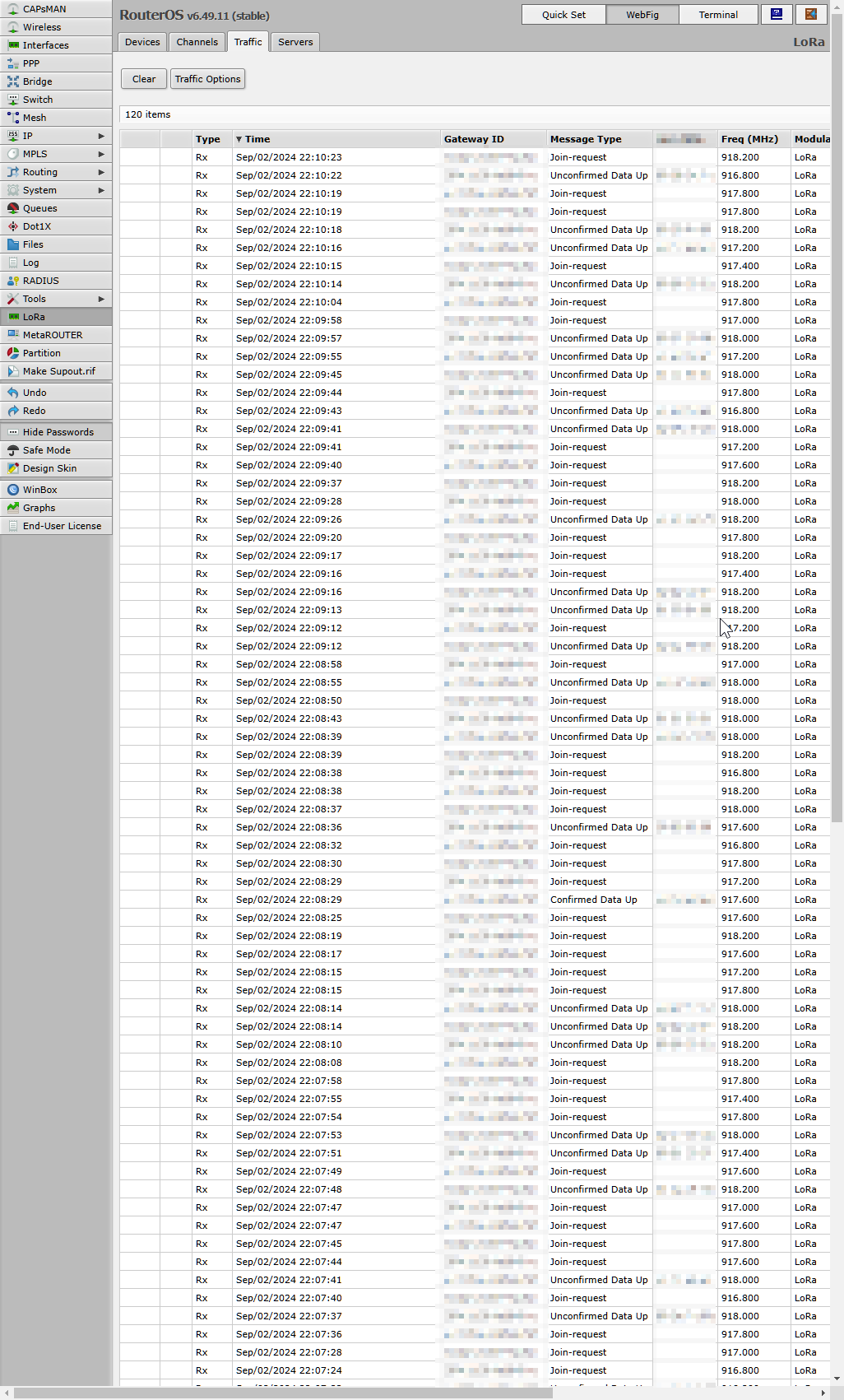

I have about six or seven gateways are being affected by a device that is attempting a Join Request about once every second.
Is there any way I can block or blacklist this device? Apart from the noise/DoS issues, its approximately 3GB per gateway per month of data which gets a little pricey for the 4G gateways.
The Join EUI is 70 B3 D5 7E D0 01 54 83, which is a TTN device, but it never gets a response

I’ll give this a go. I already have a rough idea of the location based on RSSI from multiple gateways. I guess it’s time to break out a Yagi, offset attenuator and TinySA. At least the regular transmissions will make it easier to track down.
Granted it has been doing this every 1-2 seconds for over two months, so no rush to get out there and deal with it now.
