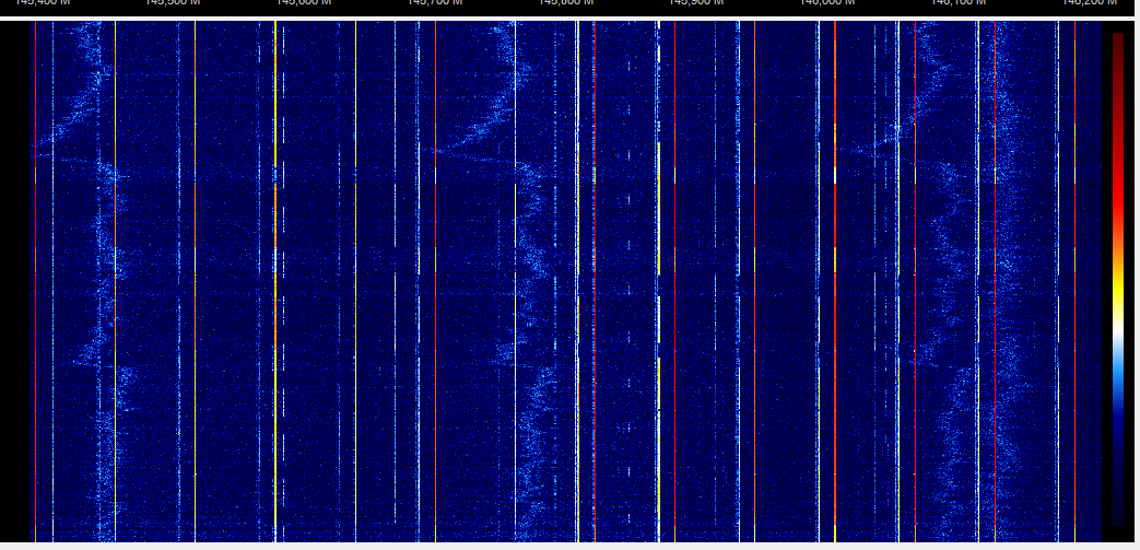

And the noise is measurable in a radius of 5 meters with SDR-Radio and two different gateway
almost the same hardware but different DC-Converter and different powersupply.
Here is the waterfall diagram what displays very clear the noises.
Screenshot from 09/25/2018
waterfall
