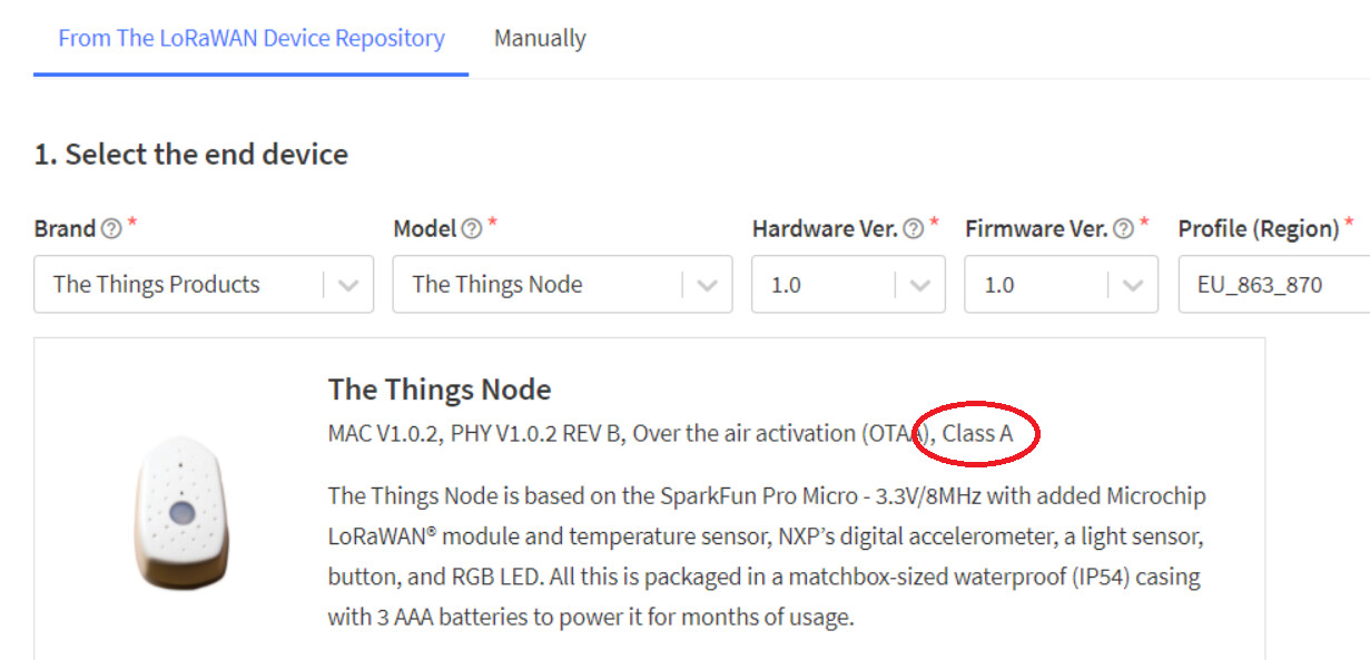

Have used dozens of these in the past (and currently deployed) but never as Class C… I dont know if even capable - I suspect not! See below
If inclined you might dive into the code repository on GitHub and take a look in the details to see if B or C could be supported (or implement yourself?). Node was developed effectively as a technology demonstrator/learning device and never really optimised (e.g. out of the box not particularly low power (for a technology whose stength is low power/long battery life :wink: )
Note: LoRaWAN ‘requires’ that ALL devices support Class A, Class B & C, however, are optional so recommend you look carefully at specs for any devices you are looking at ‘off the shelf’, or perhaps question supplier wrt capability.
