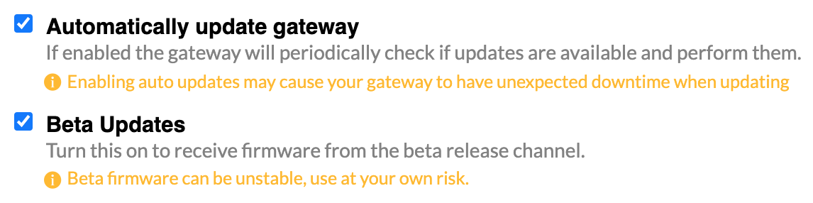

@htdvisser or @KrishnaIyerEaswaran2, which update does The Things Gateway get when not enabling beta updates? Mine uses 1.0.8, but it has beta updates enabled:

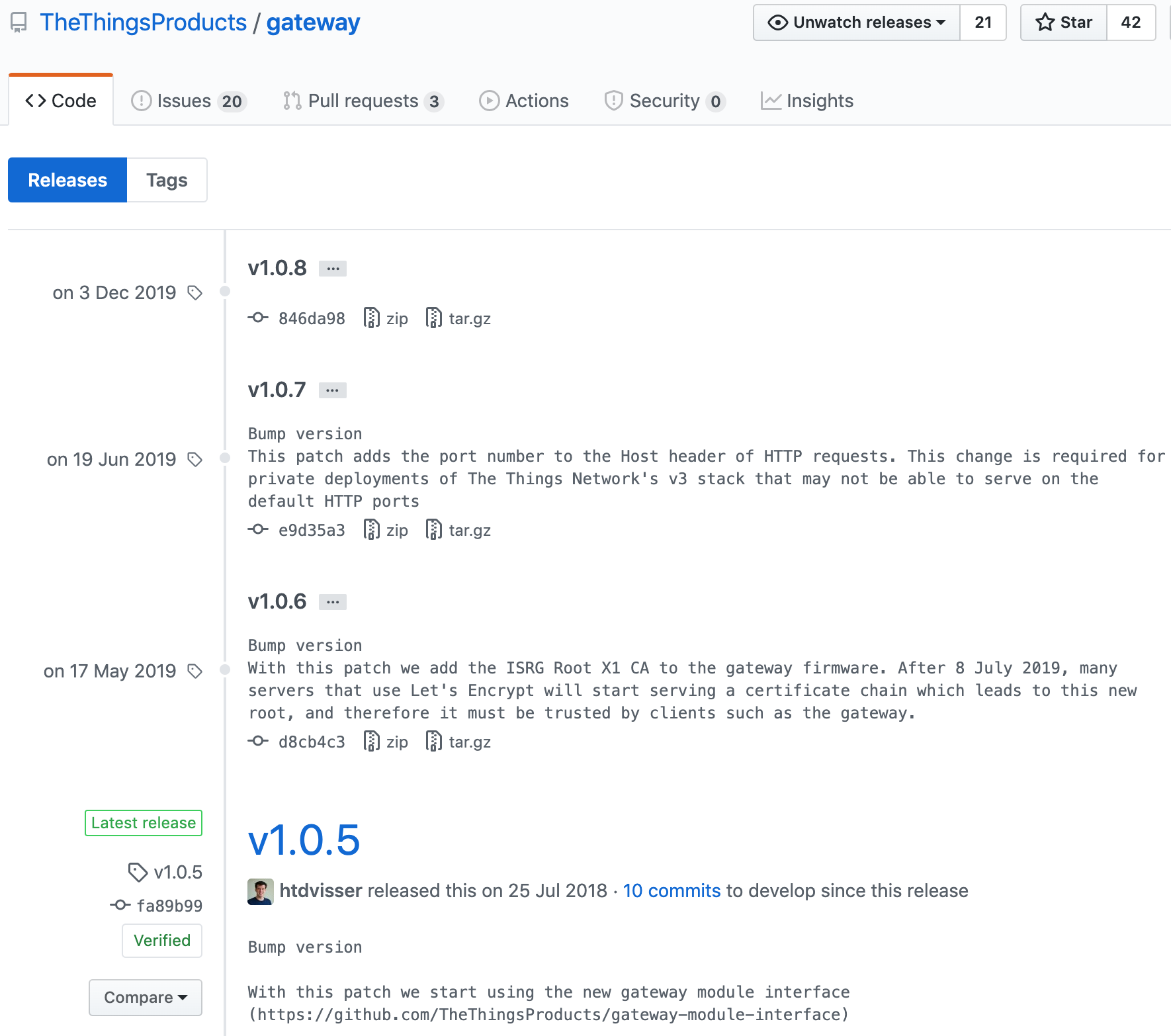

On GitHub, the “Latest release” is still 1.0.5 though:
Releases
1.0.6 states that “After 8 July 2019, many servers that use Let’s Encrypt will start serving a certificate chain which leads to this new root, and therefore it must be trusted by clients such as the gateway.” But endpoints such as https://account.thethingsnetwork.org/api/v2/frequency-plans/EU_863_870 still use DST Root CA X3, not ISRG Root X1 CA. So I guess even 1.0.5 still works, today?

The Things Kickstarter Gateway gets its updates from the branch that’s selected in the Account Server. You can find the list of branches here: Branches · TheThingsProducts/gateway · GitHub
The 1.0.6 patch with the ISRG Root X1 has been on the beta channel since May 2019, and on the stable channel since June 2019.
Currently (June 2020):
  • The stable branch is at 1.0.7 which makes the gateway work with our v3 stack.
  • The beta branch is at 1.0.8 which makes the gateway work with AWS certificates.
Looks like we only pushed the git tags. In our other repositories our CI marks new Releases, but apparently that’s not the case here. I created the GitHub releases.
