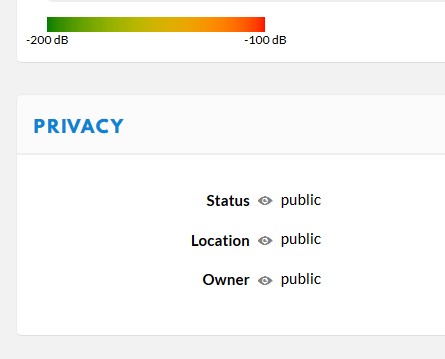

you can set gateway privacy settings in the console
54%20PM
Ah, so do gateways require locations, but they can be hidden?
