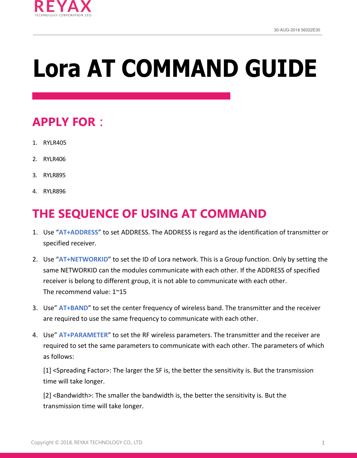

Here is the command manual
Unfortunately that suggests these neither implement LoRaWAN nor offer sufficiently fine grained control of the radio to do so on top of the AT commands.
So the only real choice is porting a new codebase to the board to run in place of the AT command firmware, or using a different module.
