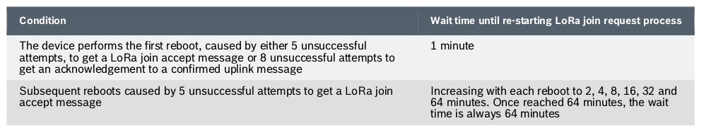

Thanks for confirming and also for the heads-up, that was one of my concerns, mainly because it would be a waste to leave it hanging over the weekend while I was waiting on the appkey.
If anyone stumbles on the thread here is the expected behaviour: PLS| Communication Interface - Technical Description rev.2 pdf
