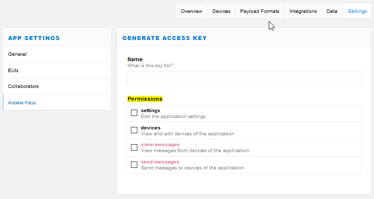

Can someone explain me why there is no distinction between read and write permissions for access keys? Eg, If providing an access key to a dashboard, you would not want that application to be able to change node parameters, eg . transmit interval, time, reset etc.
A mockup example below for clarifying (this is not the current situation)
Tiny remark : I think the interface should state “permissions” instead of “name” (yellow highlight)
