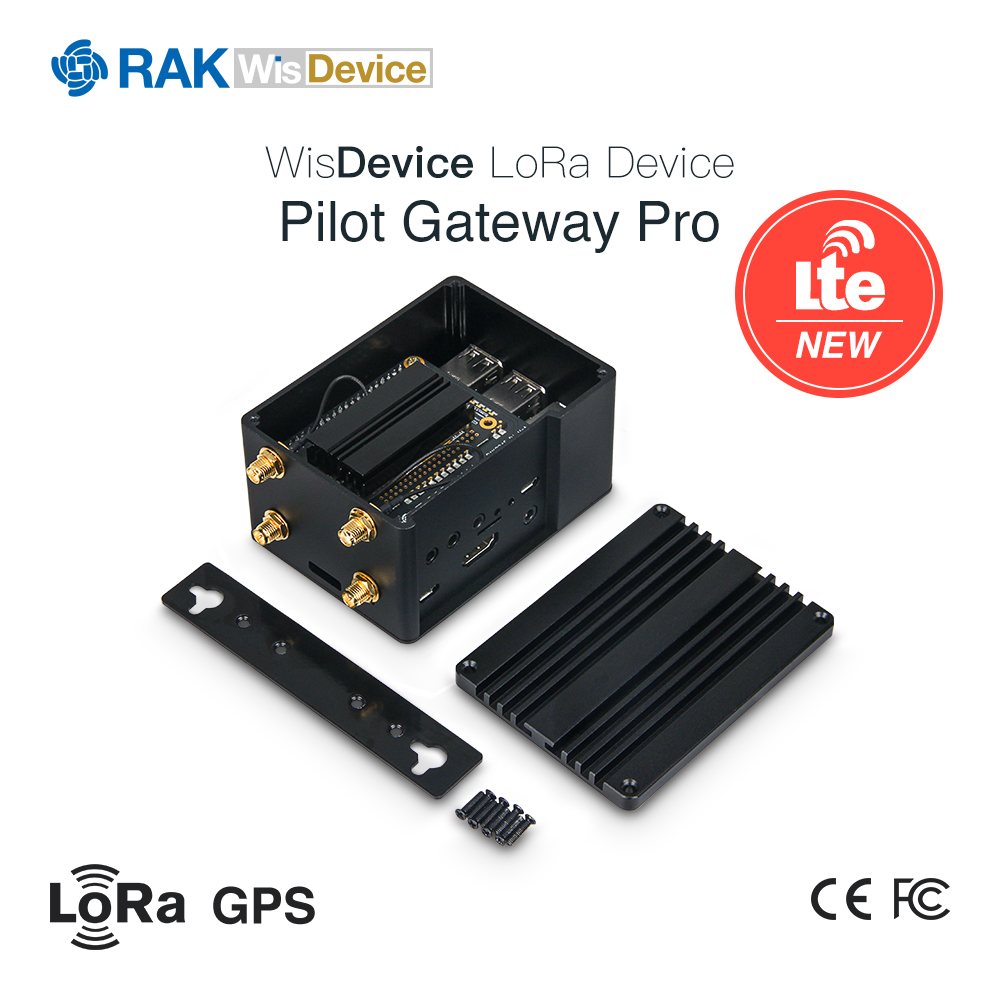

A good pice off hardware is a Pi, with two board on it like this from RAK
Succes with your mobile application
he asked for NON DIY :wink: (a specific ‘car’ LoRaWAN gateway I didn’t see … won’t be a market for that probably)
The Rak install’s come’s all most out off the box that it works. And If you see how nice they build it together on this moment. But you have right BorRoz it stays DIY.
