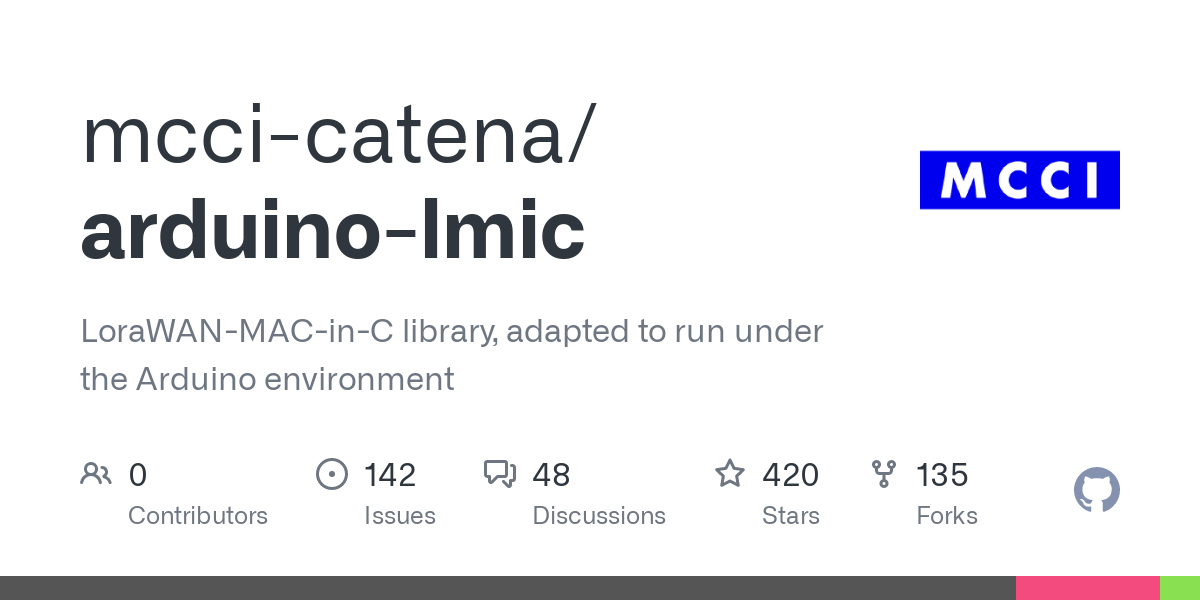

Only since v3.1.0 from Jan 2020 has LMIC been Class A compliant and still had two further releases in May & Dec to fix issues. Before that it could only just about cope with ADR properly.

Er, no, as it says, that’s an application that wraps up LMIC to make it easy for people to program on the list of microcontrollers in the Readme - the Pi being conspicuous in its absence.
Try:
There is a very good reason that it’s for the Arduino and that there isn’t much up to date for Pi …
Thanks for the pointer to this code. I had not realised that the other code I was looking at was quite broken!
I’ve made a Raspberry Pi version of the hal.cpp code and it is working well - I am receiving Join accepts and other downlinks. And I am no longer getting a downlink for each uplink. No changes were required in the rest of the code.
