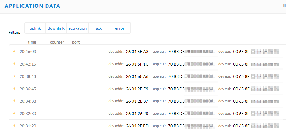

Hi all, I’m using some arduino+RFM95 based nodes, which work fine. But since this week, the activation via OTAA fails. This first happened after an update of an existing node, and now also affects an other node, which is unchanged, only just resetted to see the reaction.
The effect in the TTN console: I see the “yellow” activation messages, they look normal, and I see the node is increasing slowly the SF, because it does not get a confirmation. I was assuming that maybe the node cannot hear the GW because of local noise, but also moving the node to a “silent” environment did not improve the situation. Now my impression is, that it is not a radio issue. Because: normally the network should send a “green” activation response in the TTN console, right? I see only the “yellow” requests, again and again, without any response of the network. What can be the reason for this? Is there a “too often activation” suppression implemented? Can this be “reset”? The frame counters are zero anyway, explicitly resetting did not improve. Any idea?

[Edit] The link to the gateway(s) is perfect. I have one node which is “shouting” the activation messages with SF12 and up to 5 gateways hear it. Best SNR is plus 8.

Yes and no, every activation needs a unique seed value, there are 64k of them available as the data structure is 2 bytes. However the yellow activation icon in the application data shows the backend recognizes and accepts the activation and schedules a response.
