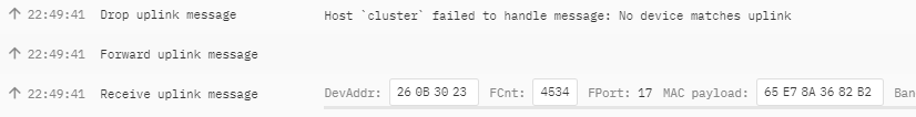

Your log does not appear to show a join request, but rather in-session traffic from someone else’s node (or maybe your node, misconfigured).

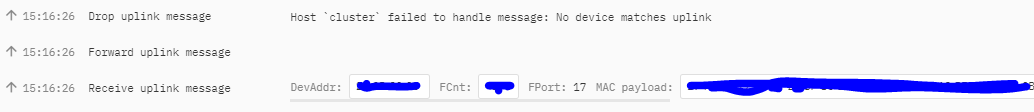

Please don’t blank out the non-secret device address, if you hadn’t done so people could see if it’s even a TTN device address, traffic from TTNv2 with which V3 can do nothing, or even traffic from an entirely different network.
This is the message from the gateway every time I press the button, so I am pretty sure that it is the node
