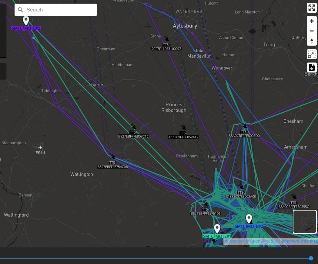

Have spent odd time looking at IoT Wonderland (see the TTN “Webhook” Integrations list) aka lorawonderland.com (fun keeping that domain I guess if L-A or Semtech pick up on it!), aka Copernicus Tech IoT Wonderland Platform - Copernicus Docs ) over last approx. 6-9 months. I was recommended to give it a try after the myDevices/Cayenne community site shut down last summer :frowning: - which had been my previous go to for quick sensor/tracker demoes etc.
You will be dependent (for now) on their list of supported trackers - haven’t figured out how to add alternates without asking directly (*) though they stepped up and did a decoder/option for the original Semtech/iMST LoRaMOTES/trackers when I asked/suggested.
Frankly felt a bit late Alpha/early Beta in use and wasnt a totally smooth experience but when it worked it worked well wrt basic Tracker dashboard presentation & ability to choose time period for review - YMMV.
One of its strengths was option to select which of your trackers you could see on screen at any given time/period - note not suited for real time tracking/asset location - TTN FUP still applies!!!
Example (shows 3 devices in play):
