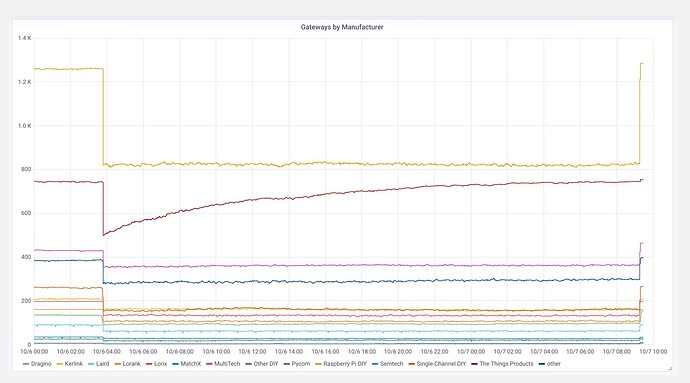

2 of my 5 gateways are showing as not connected. Both of the not connected gateways went offline at about 4am UTC today. They do not share any common power or backhaul. Both systems are up and running, just not connected. One is using the Semtech UDP forwarder and one is using the TTN forwarder.
When I look at the TTN map it appears that a lot of gateways are not connected.

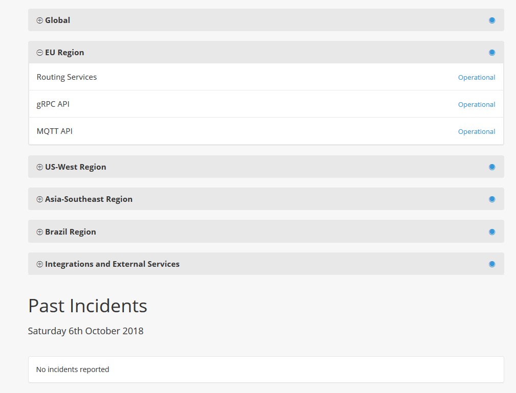

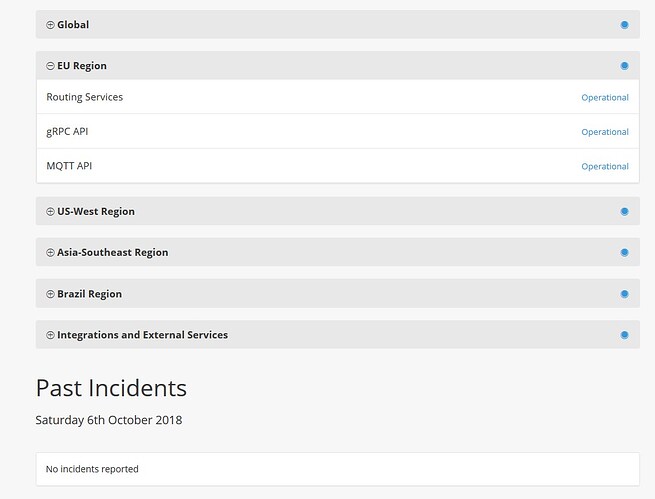

Is there a partial routing outage in EU?
Update: I think that traffic is flowing normally but the TTN web console is showing the gateways as not connected.
TTNctl reports my gateways are all up with recent last seens, but currently 3 of my EU gateways are showing down in the NOC. Two are UDP packet forwarders, one is an official TTN gateway. The three gateways are: 985DADFFFE51357D, 0242ACFFFE120003, and kentnetwork-ttngateway1. Traffic is flowing and a private NS reports no issues.
so it’s probably a NOC related problem
probably as the UDP is getting acked by bridge. Already raised this in Ops on Slack
take some time to see this ‘incident’ here :wink:
SLACK #OPS channel - Slack
they are notified !

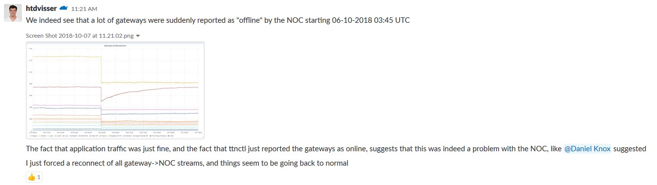

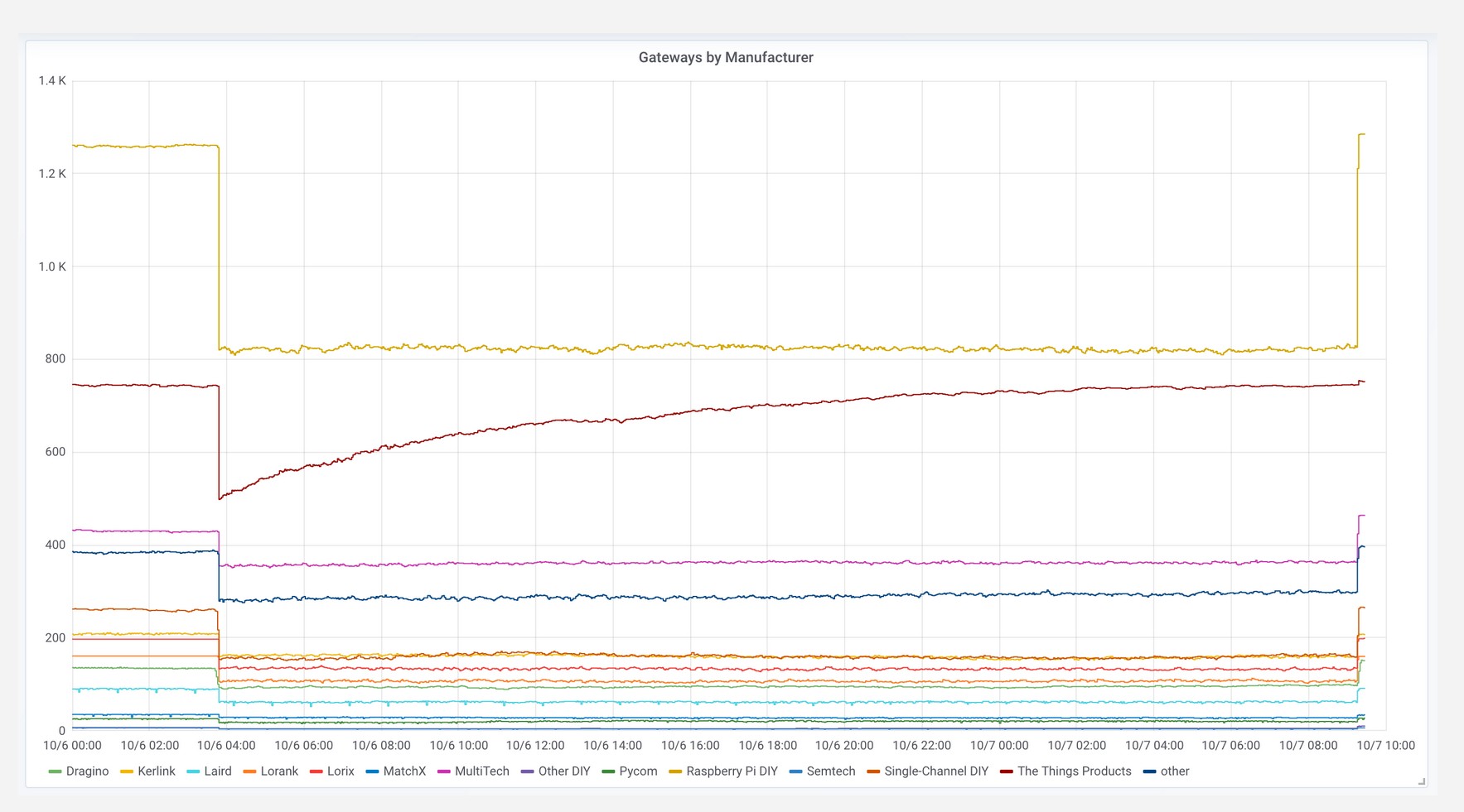

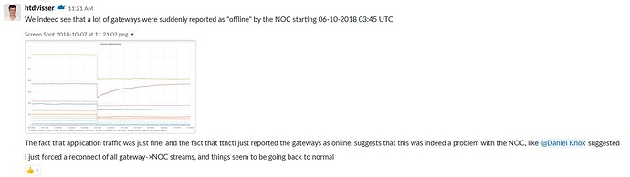

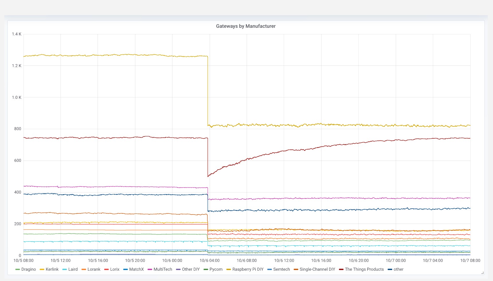

  • update
… and back to normal… tnx @htdvisser
