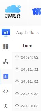

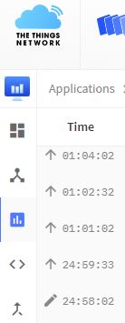

I wonder if it is a consequence of having the console stream open during the rollover of the date?
I have since reduced the frequency of uplinks (it was temporary rate while commisioning a new solar powered node). I was actually trying to determine the number of uplinks at SF7 before the LiPo became exhausted following a couple of hours of sunshine earlier in the day. It is lasting longer than I expected (which is good!).
Yes I was using Chrome (latest version)
As it happens I had already setup a test for this evening to compare Chrome, Edge & Firefox side by side. Looks like you have already narrowed it down.

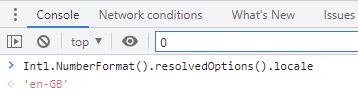

However just FYI, locale is en-GB as confirmed by the Dev Tools…

… I have updated the PR with some additional data showing that it is not just Chrome that has the timestamp issue. Last night I repeated my test with FireFox, Edge & Chrome all watching the data when the new day started.
Result was Firefox is fine but the Chromium based browsers (Edge & Chrome) get it wrong (at least for en_GB). My test was purely superficial & didn’t try to exercise other locales.
That was my suspicion when you posted update - I hadnt seen the problem personally…90% FFox based, as also use other none Chromium/Chrome monoculture based browsers where I can - Safari or FFox on iPads, FFox on android, otherwise Edge (Chromium based) if I must - say on guest PC’s @ host sites etc. Thanks for update/confirmation.
