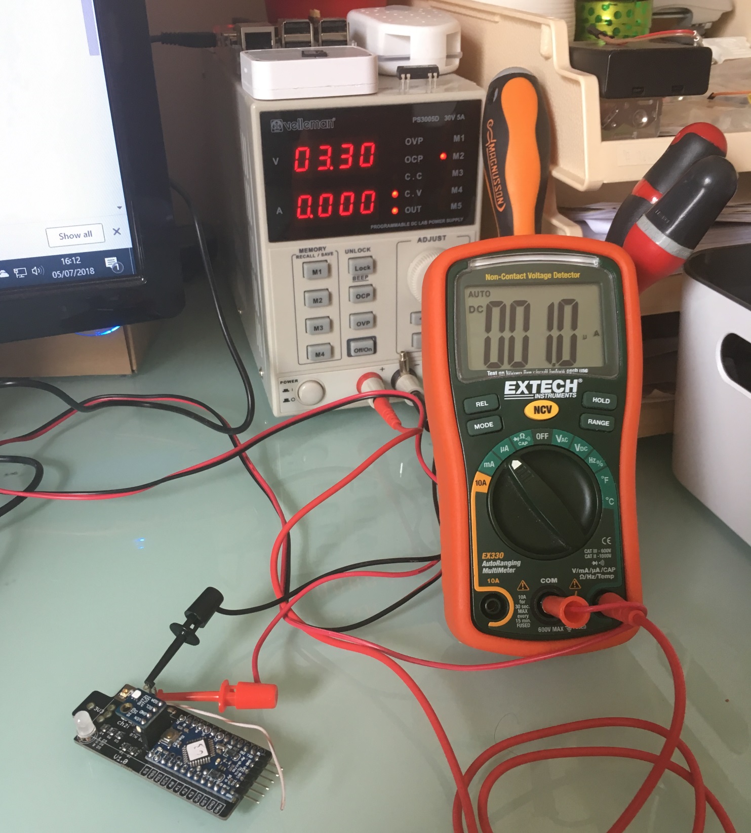

Here a picture, 1µA :wink:
IMG_4651

Errr…is the module asleep (as in able to wake up relatively quickly) or completely off and booting from cold?
It appears to switch off power completely, how would it otherwise be able to get down to 1nA battery use in sleep mode. The nanoPower board does however require its own battery which will last for (only) max 1 year.
Its off.
For a lot of situations, that is just fine.
I am working on building the circuit into an ESP32 powered board. The addition of the RTC is useful in itself and you then have the choice of effectivly zero sleep current by powering down via the RTC or 10uA with standard ESP32 deep sleep stuff.
I wanted to have the option of also allowing the board to use the SD card for logging, but powering that down seperatly to a LoRa devcie introduced too much in the way of complications, so using the RTC to power down the circuit is one way around this.
