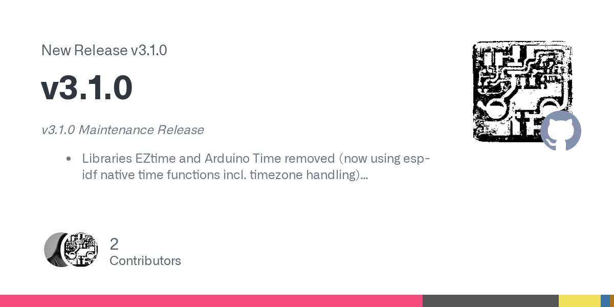

Today new paxcounter software v2.1.0 was released:
New deep sleep mode
New mac filter logic (includes remove of formerly used vendor oui filter)
Wifi channel hopping can now be switched off (means sniffing is locked to first channel in band)
MQTT code reworked, to reduce disconnects

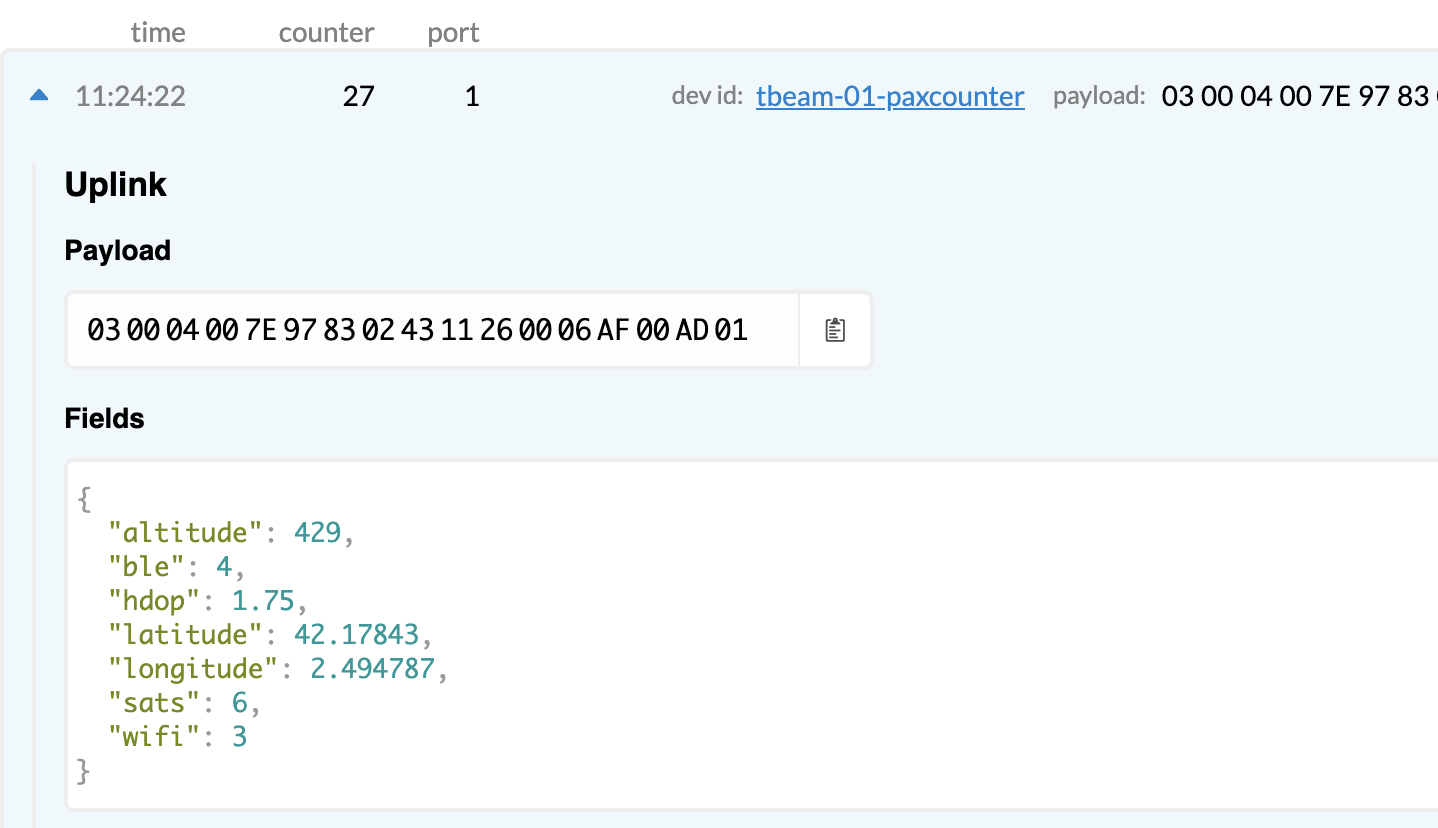

Wifi+Ble scan works fine in my new T-BEAM (T22_v1.1 20191212)
I can see data in my TTN Console, but I don’t see GPS data.
By default, GPSPORT is set to 4, but not work … and I try to set it to 1, to send combined GPS+COUNTERPORT payload, but nothing happens, only Wifi & BLE count devices are displayed with the payload decoder.

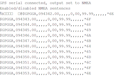

On the T-BEAM board, there’s a red led blinking … under the GPS chip, but never fix.
Perhaps you can try this sketch to reset the GPS.
The board with Meshtastic preinstaled can behave very odd.
If you have a version with the ublox M8N GPS chip you can expect problems with timesynchronisation.
There is already an open issue in the github an a solution in this thread a few weeks ago.
I try to upload T22-GPS-reset-v3, but it seems that doesn’t works.
Maybe I need to try this sketch ? T22-GPS-restoreFactory-v2.ino
My GPS module is NEO-6M.

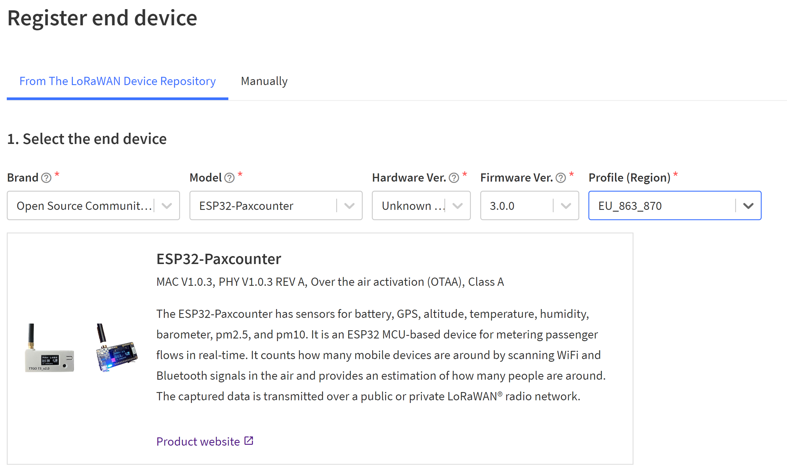

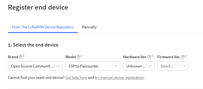

It’s funny because Paxcounter is actually not a device but a piece of software that runs on different types of hardware devices (where each type can have different hardware versions).
I was wondering what options the “Hardware Ver.” dropdown provides, but currently there are none.
Is this by design? It’s not clear that no Hardware version must be selected here but a firmware version can be selected (because Firmware Ver. appears greyed out).
I would expect to to see a list with supported hardware under “Hardware Ver.” but maybe this can only contain numbers and not strings?
