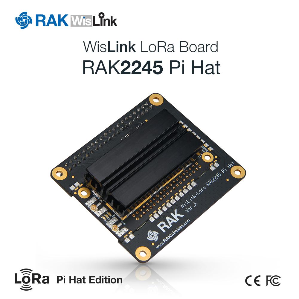

Maybe a RAK2245 hat (GPS included) combined with RPi(3/4)?
Antenna connector is IPEX/U.FL but it’s possible to replace it with SMA connector if needed.

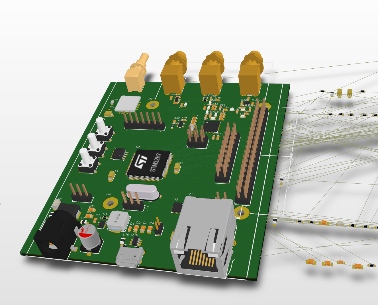

I am currently routing one for my local community :smiley:
grafik
  • Single channel gateway for mapper experiments and HAM Radio LoRa APRS on 70cm (433MHz)
  • CPU: STM32H7 (480MHz ARM Cortex M7) that can timestamp external events up to 8.33ns resolution
  • LoRa: SX1276
  • GPS Receiver 20ns 1PPS accuracy
  • 10/100MBit Ethernet
  • RPI Hat compatible
  • supports RPI PoE Hats
  • connector for I2C displays
  • Supply: 5 to 25V DC external, 5V over USB or via PoE (with RPi PoE hat installed)
  • Price? <100USD is the targed price (+VAT, Tax, customs, we’ll see)
  • Availability? By the end of this year I hope.
Interesting board, which GPS are you using ?
SierraWireless XM1110
https://www.sierrawireless.com/products-and-solutions/embedded-solutions/products/xm1110/
Ah, thanks.
So timing at the 20nS accuracy region from a low cost (£10 ?) GPS.
Right, that is the idea behind this project.
It does look very promising …
