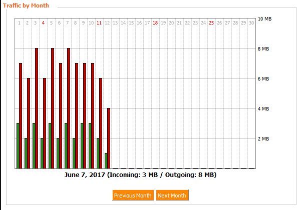

For those who are interested; This is the data on a per day basis that is being registered by the router of our gateway de Mheen in Apeldoorn. Maximum is 8 MByte per day.
And meanwhile 10 MB :wink:
hmm… really? 10MB/Day? With an average datalength of 35 bytes this would mean 285714 msg/day. divided by 86400 seconds aday has makes 3.3 msg/second.So your console gateway traffic page must fill up faster than you can read it…
Even with NO payload you get some Traffic. And every Packet adds much more Overhead than you have with the payload.
@moeterbin I was assuming an average payload of 20 bytes and therefore an average package datalength of 35 bytes. Is this assumption wrong? What are then realistic values for the msg/second calculation?
