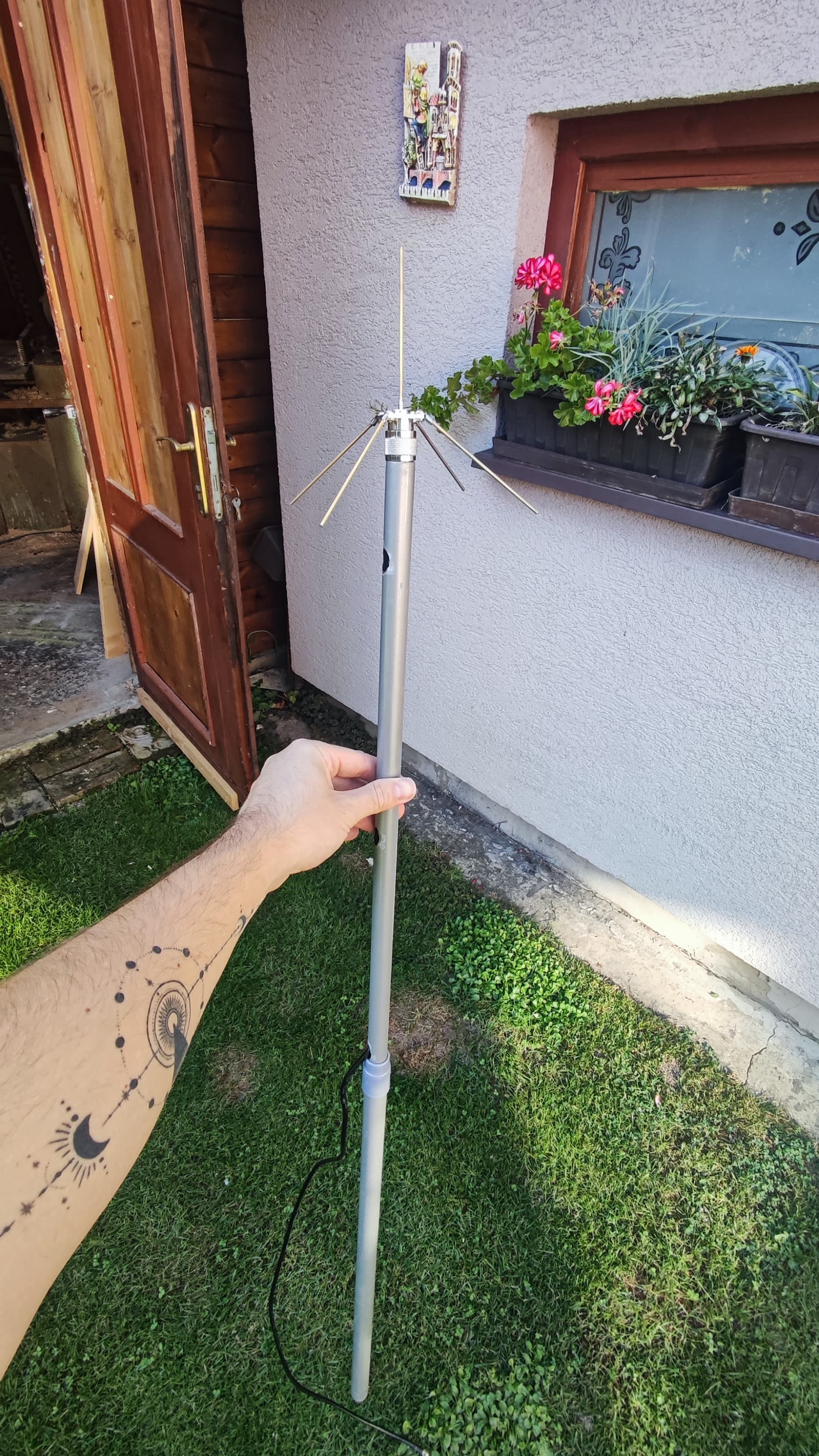

Today I made this GP antenna, thanks for this!
I have question. Can I mount it on aluminium pole as it is on the photo (touching the ground)?
Or the antenna should be isolated from the pole? I will be using for LoRa.
Yes, this is one of the best ways to mount an GP- antenna. On top of the pole and as high and as free as possible.
Nothing nearby, this gives you a perfect round- radiation with vertical polarization.
The shield of the coax can and should be, but doesn’t need to be connected to the pole (ground).
