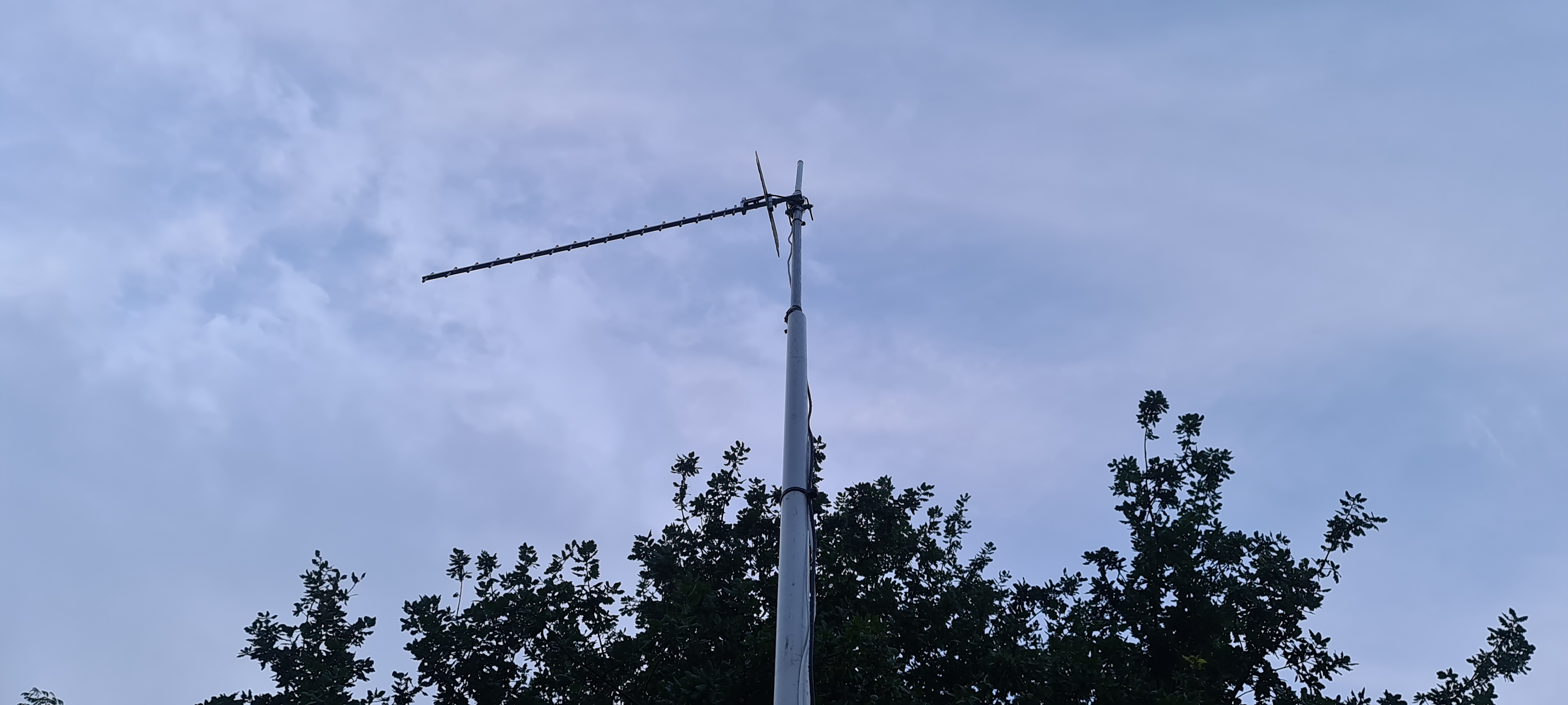

Generally, of course. Unless you actually want to receive packets from far away such as in the case of LoRa enabled life jackets or other critical devices used at sea.
Like this one of mine, proudly pointing out over the Irish Sea.

I assume your LoRa-enabled life jackets are not using LoRaWAN? Hence, this is not connected to TTN? All fine, of course!
That’s fine, unless that network is connected to the TTN Community Network, which is what this forum is about. On TTN, don’t do this please.
