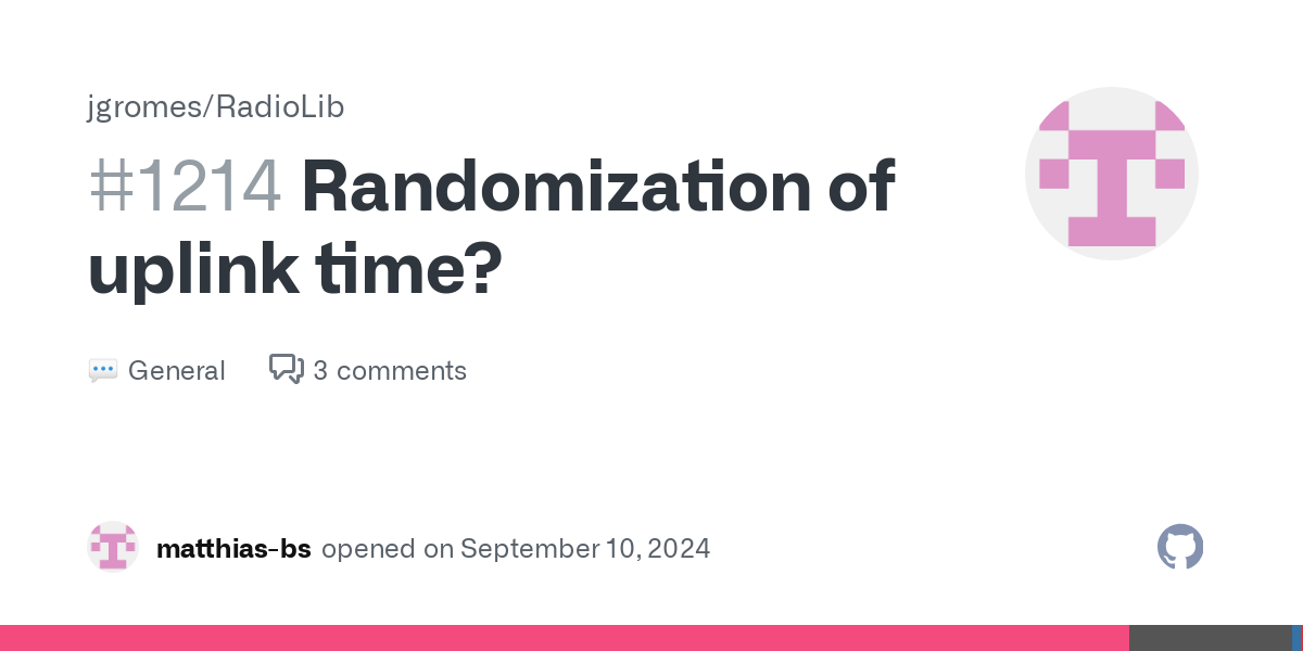

Yes, but NOT 10 seconds - its all over the RL discussions and is in the LoRa Alliance TR007:
