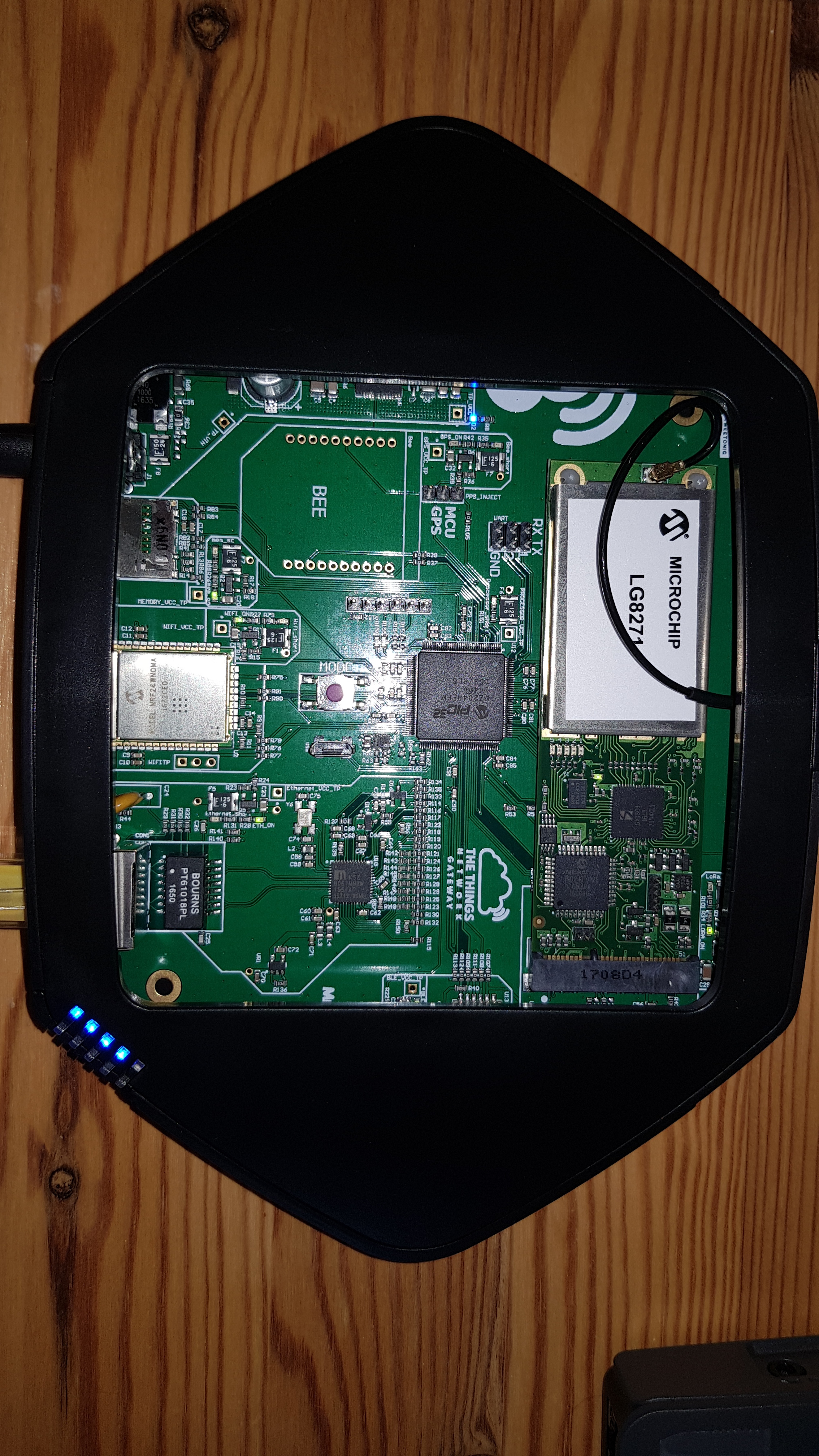

The LoRa board is fitted under a bit of stress in the 1636D4 socket. The plastic pins connecting it to the mainboard pull it down, bending the board it seems. I was planning to reseat the board, but noticed that it involves removing the antenna connector first as it is in the way when taking out the LoRa board. That and the fact that the board seems to be fitted a bit awkwardly made me think twice, so I got a cup of coffee instead :wink:
Initially when the gateway wouldn’t connect to TTN it was sufficient to push and wiggle the board a bit to get it going.

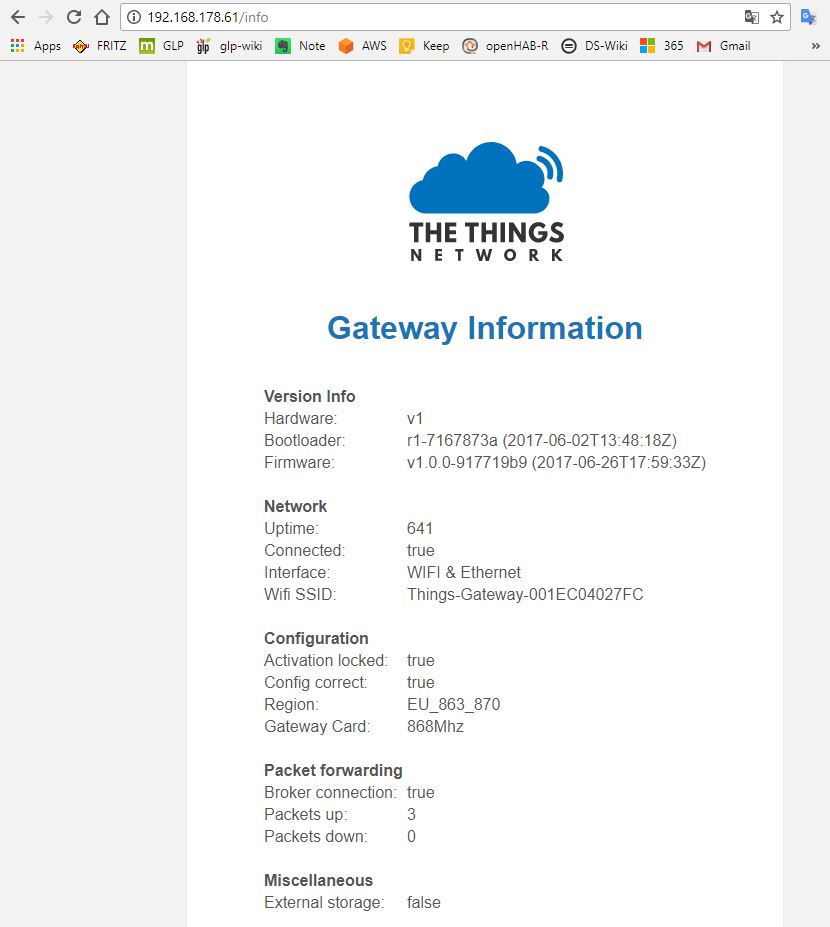

Today I received a new second ThingsNetwork gateway. Works without any troubles!
I asume there is something wrong with the hardware by the rebooting gateways (like my first one)Gateway2_is_OK
Connected only by lan. I will check what is other…later.
Uptime: >2000 :slight_smile:

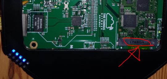

The same firmware but there is a difference by type. My malfunction Gateway 1636D4, the new, good one 1708D4! see picture.31

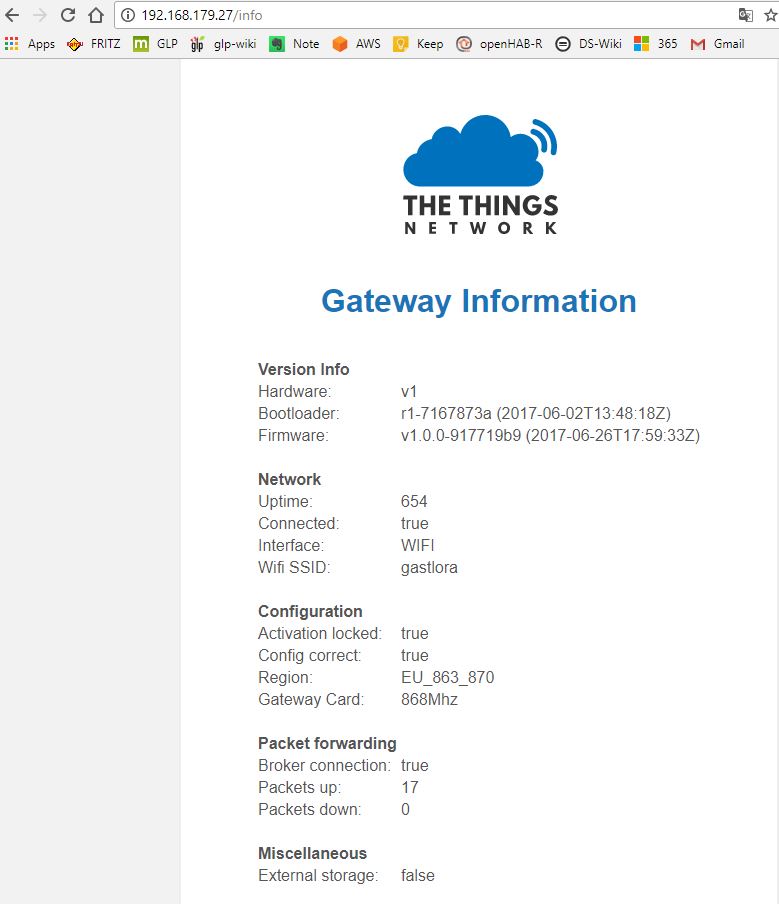

Gateway2_is_OK_WiFi
The second gateway 1636D4 works also by WiFi only. Data from nodes ok, and connected!

Remove the white cover to see the board number (pull slightly upwards at one corner of the white cover to remove it). SerNo. If there is number 1634D4 I asume it will never work.
That’s quite a bold statement, especially as you’re the first to mention that version, and as people see improvements just by installing different firmware? (For me, 1635D4 which is okay for some, was in a reboot loop until I installed different firmware.)
You’re right. In the meantime I had contact to a second owner with a 1708D4 - the same problem. There are many people, that loose many time with such malfunction gateways. I tryed different ways (software, hardware, connection lora-board, wlan, lan, software…also the second guy), nothing worked. Thats not the idea…
