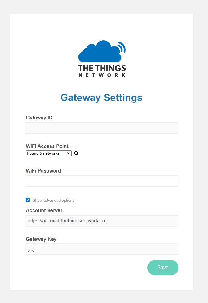

Now I updated the firmware from 1.0.7 to 1.0.9.
Connect to my wifi but I can’t write ID, this field is disabled :face_with_diagonal_mouth:
Ok, I reset the settings and it works. Only one thing bothers me, after inserting a memory card with new software as in the description gateway/firmware at develop · TheThingsProducts/gateway · GitHub, I get info of version 1.0.9 on the UART console when I remove the card after a reset, I have 1.0.7 again on the console, how does it work?
I believe that once you update via the card the card has to stay in as it is then booting from and using that IIRC. Again IIRC I think there was a post a year or two back that suggested that though ‘requirement’ is for 1.0.8 or above it was suggested that 1.0.7 ‘should’ still work, and indeed if if did then when system checks for updates it woudl migrate to 1.0.8, 1.0.9 or whatever was then current, using internal memory vs card. Might be worth simply trying to install and run as registered with 1.0.7, leaving the check for and permit software updates option checked and see if over time (probably quite quickly) it then takes the updates… One issue with uSD cards is life expectancy and any issues around lack of graceful power downs (as happens with RPi’s) so good to try and avoid if poss but if its the only way then I guess you need to stick with the card…
