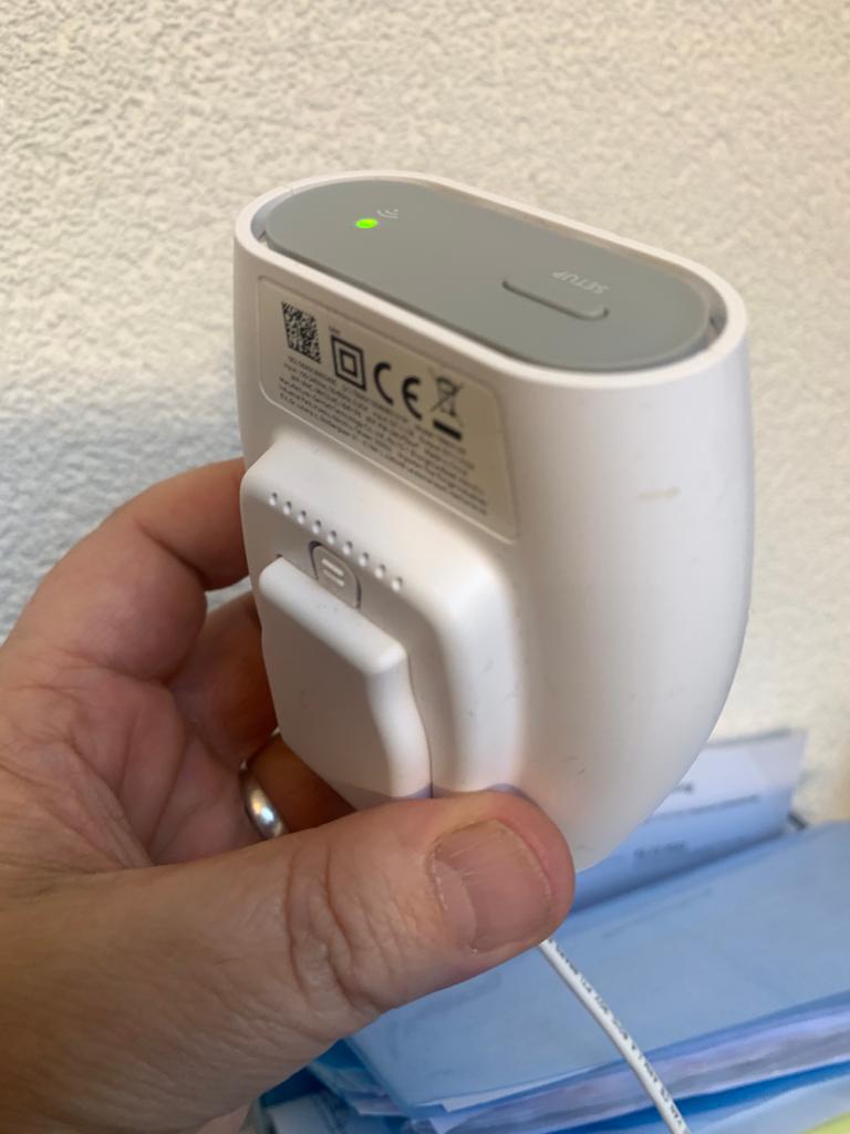

Ps… The reason I have this situation is that I deleted the GW from my console by mistake. Hence, GW was bought, a GW ID fr-1773 created, GW EUI assigned to the GW ID, connected to TTN via WiFi, then accidentally deleted from TTN console. I then created a new GW ID 1773-val and unsuccessfully tried to register the GW against this new GW ID
@vigijay: Can you send me a photo of the back panel of the gateway (where the EUI is seen) via a private message?
If I can confirm that you physically own the gateway, I check what needs to be done to allow you to claim it.
Actually it IS a TTIG :slight_smile: (Things Indoor GW

Suggests prior deletion hasn’t taken or some residue stuff in claim database…. Krishna is your man to get that sorted :slight_smile: drop that picture of back of device label to him on PM per his request and he can fix I’m sure….
already done :wink: thanks again!
